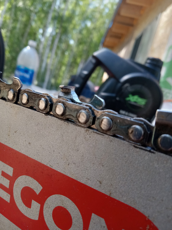

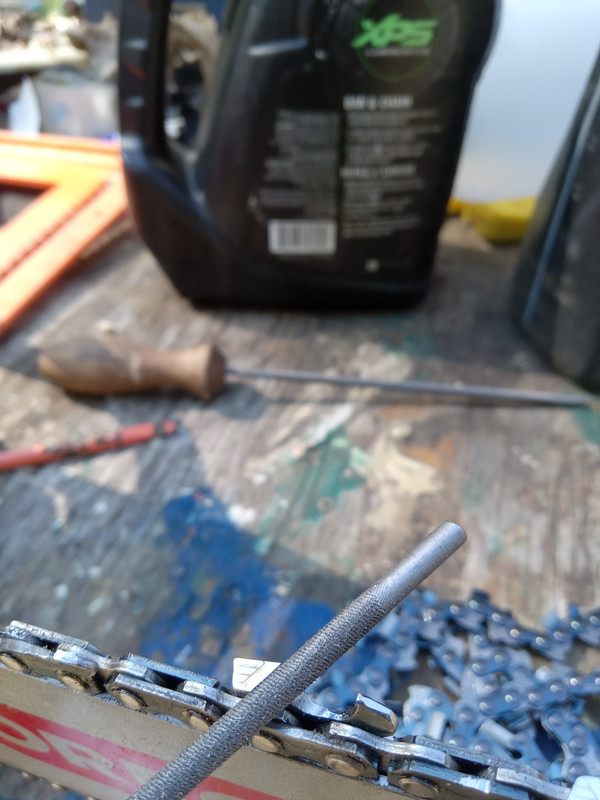

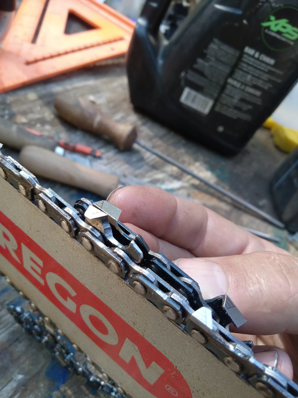

EXL slows down a bit towards the end of chain life. With the cutter so far gone, a normal file for 3/8 is obviously too large. So I switch out to a file for 3/8 low profile. To start with, out of habit, the junk in the gullet is always filed out.
Few more things: Later tonight, I'll post up cut times of this chain against new EXL. My appologies that there are slight file marks on the tie straps, but I honestly really don't give a fk. There is no "name" for this file job. Explaining this out in detail, is kinda crazy, because it all happens in less than 5 minutes of files strokes on an 84 dl chain!:

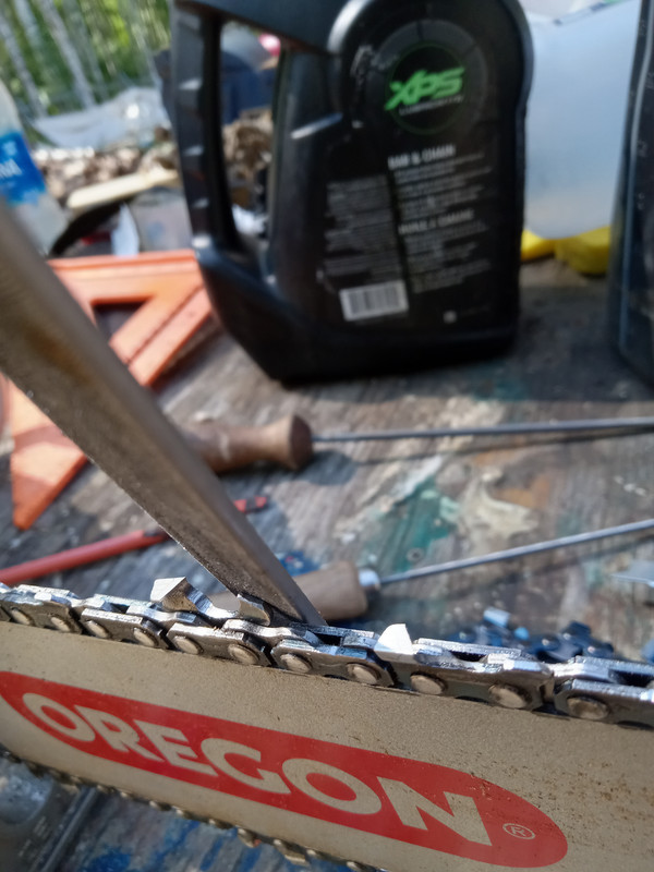

1: hit the cutter with a 3/8 lp file. Use light strokes, these smaller files are frail:

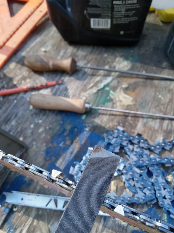

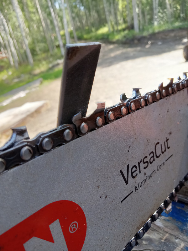

2. Reprofile the raker resting the front of the raker-file downward, guiding against the opposite drivelink. This leaves the top "tip" of the raker slightly exposed, but gives a nice gentle "ramp" on the raker, without changing raker depth.

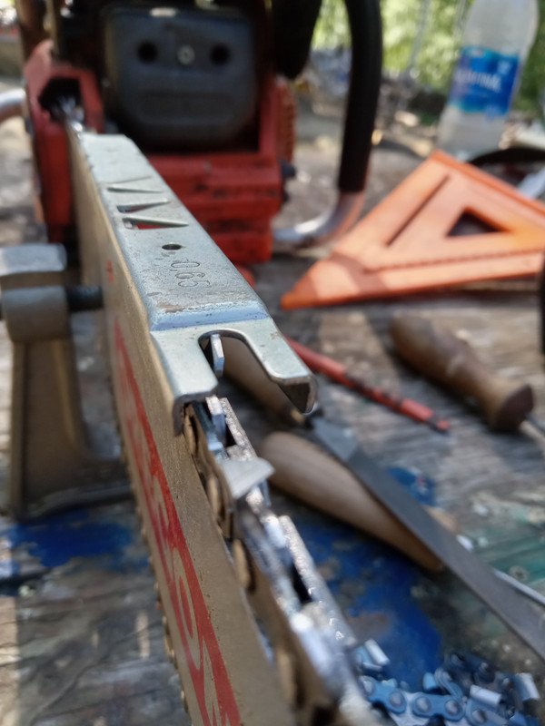

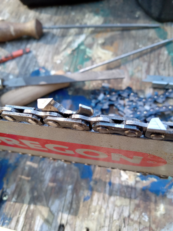

3. Bevel both sides of the newly-profiled raker. This is a big one! Less friction, less heat. I've actually gained 100-200 rpms in the cut, just by turning that raker into a dull "knife edge". It also allows the sides of worn cutters to bite a little better.:

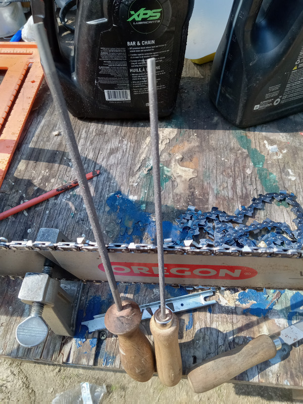

4. Finally, adjust the raker depth to your saw, in your wood. My CS 620pw in Alaska birch/white or black spruce, and smooth bore cutting, my rakers are slightly below a typical raker guage:
