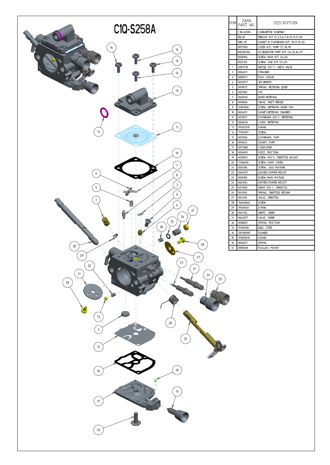

el33t Well-Known OPE Member Local time 7:37 PM User ID 29908 Joined Aug 28, 2024 Messages 114 Reaction score 303 Location Internet Feb 24, 2025 #2 drf256 said: I recently acquired a 192T which appears to need a carb kit. Would an RB-69 kit be correct? Below is a picture of the carb side. Thank you. View attachment 451768 Click to expand... C1Q-S258A | ZAMA Group www.zamacorp.com

W whybother Super OPE Member Yearly GoldMember Local time 12:37 PM User ID 23885 Joined Jun 24, 2022 Messages 118 Reaction score 344 Location USA Feb 24, 2025 #3 RB-69 is what Zama website says. Attachments Screenshot_20250224_043431.jpg 44.6 KB · Views: 2

Mastermind Chief Cat Herder Staff member Yearly GoldMember Local time 12:37 PM User ID 4 Joined Dec 3, 2015 Messages 51,759 Reaction score 344,254 Location Banner Springs Tennessee Feb 24, 2025 #6 drf256 said: Would an RB-69 kit be correct? Click to expand... Yep
Woodwackr Here For The Long Haul! GoldMember Local time 11:37 AM User ID 28333 Joined Jan 18, 2024 Messages 3,312 Reaction score 15,353 Location ID Feb 24, 2025 #7 That’s what I use on them
