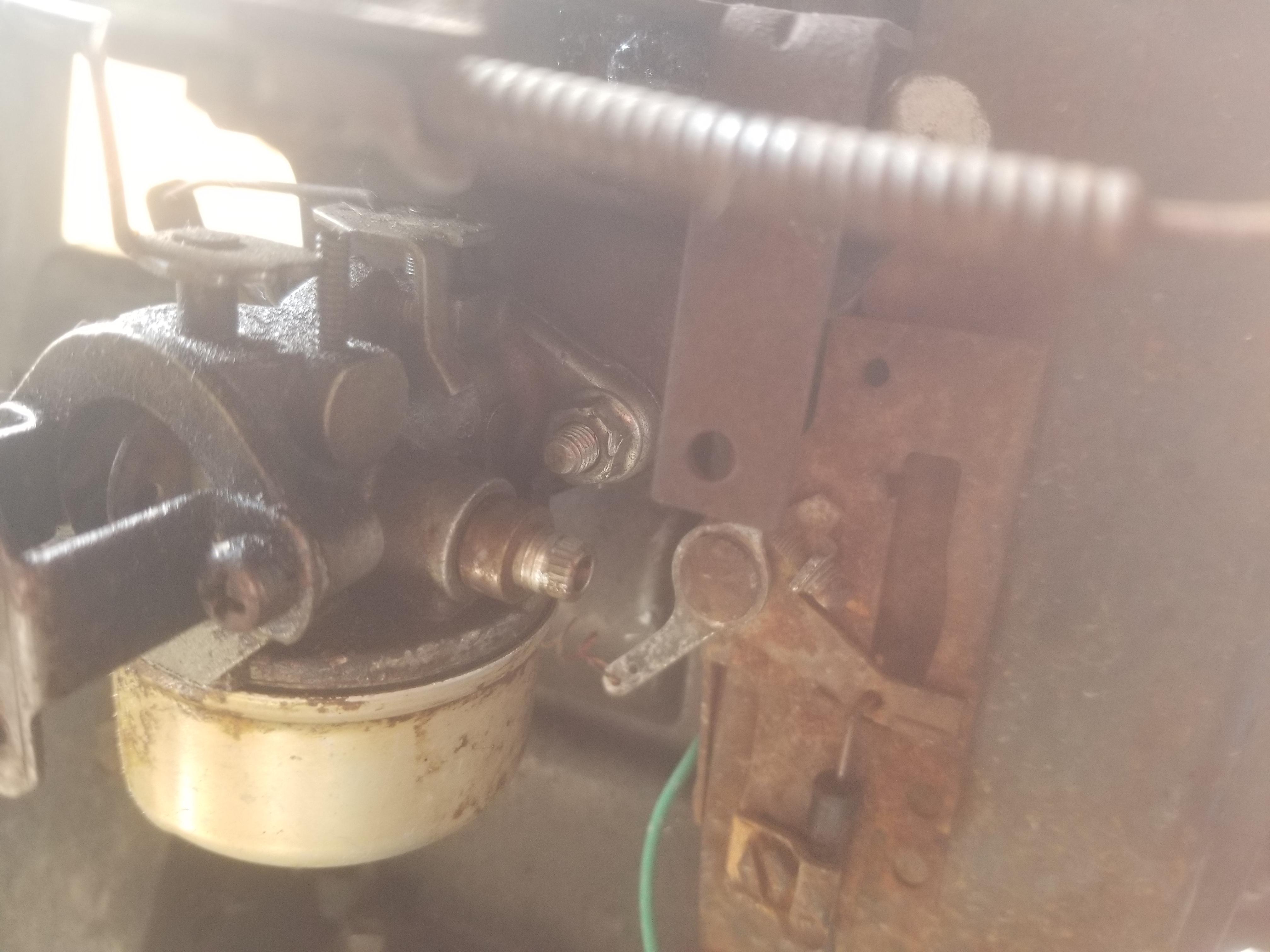

My old snowblower carb is leaking at the plastic fuel inlet. Is this part replacable or do I need a new carb. And if its replacable is it just the plastic part or the metal part in carb get replaced to.
Thanks

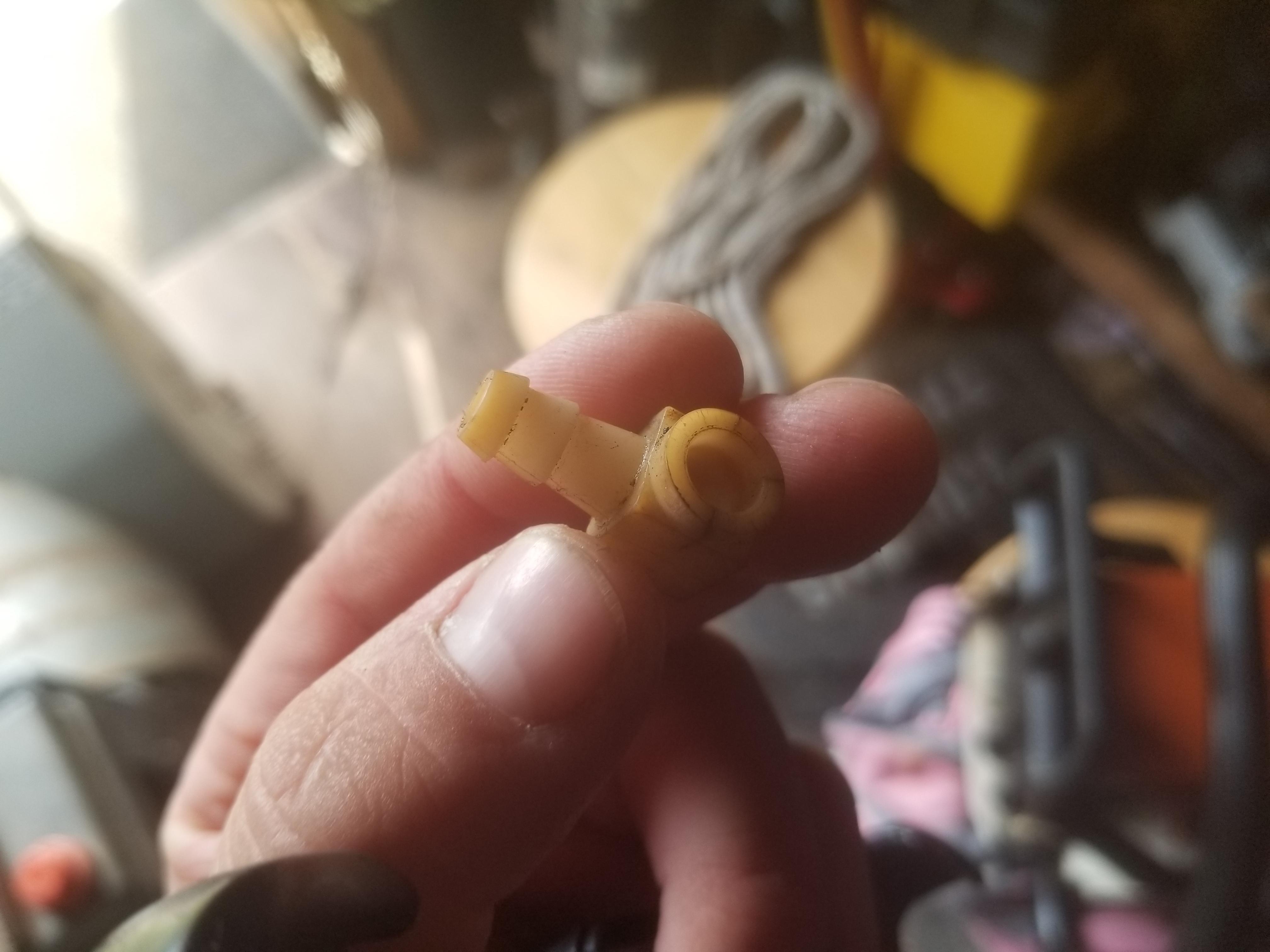

I forgot to update my post...
I got one from my local small engine shop. Was 7 or 8 bucks.
