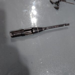

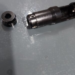

Been using this old Bushnell 740100c for quite a few yrs with good results. What i like about it is it has 4 set screws in the head under the end cap/sleeve. You can gently chuck it up in a lathe, hand spin the chuck and true up the red dot.
