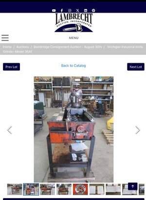

We use an ancient Michigan Knife Company planer/chipper knife sharpener from the 80s or before (I guess I’m showing my youth by calling that ancient). It’s similar to this on that sold on auction except ours doesn’t have the auto feed. This is not a fast machine either, and sharpening can take a while, especially if there is a huge gouge in a blade. https://www.laibids.com/auctions/31154/lot/171362-michigan-industrial-knife-grinder-model-36af
Thank you verry much I’ll look into it

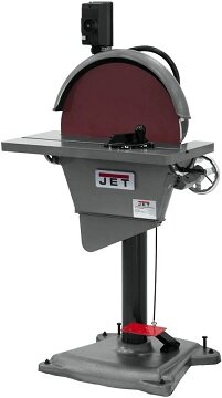

If you need to go cheap and have a welder you can always make a grinder with a massive stone and a belt drive motor, but finding a stone on the cheap is usually the issue. They are freaking expensive, a 20" by 2-3" wide is easily over $250-300 if not 500.
Another option is a big flat surface disk sander for metal, that takes like a 12-20" emery disk. Usually the surface is weighted to keep up the RPMs no matter how much material your taking off. Only issue with these is they are often not slow enough and will get your steel too hot. Id start searching industrial machining auction web sights for an old school massive grinder or disk sander. Anything from the 60s and older is built for mindless abuse and rebuildable. Even FB-market has a lot of this old stuff, its worth it even if you have to drive hundreds of miles to get the right setup....Good Luck in the hunt!
