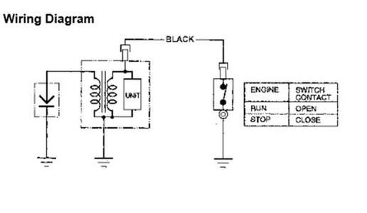

Is the resistance shown by the DMM between 1 and 3 ohms?
If so, this is the resistance of the primary winding, and it is completely normal for the continuity tester to buzz when the resistance is so low.
I think you will immediately understand why this happens if you look at this simple diagram:

Thanks so much for that diagram. I don't remember what the reading was, I was just listening for continuity. So, now it makes sense that the coil tab would always show continuity to ground. I guess the kill switch gives the electron flow a shortcut out of the windings, stopping the spark?
