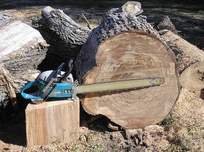

Here's the 6401 that WKEND LUMBERJAK and I rebuilt about 12 years ago. It was a great joint project and I learned a lot from him, enough to rebuild about 30 more saws:
This saw remains in my artillery and runs fine today. That's a 32" bar on board and it pulls it flawlessly.
