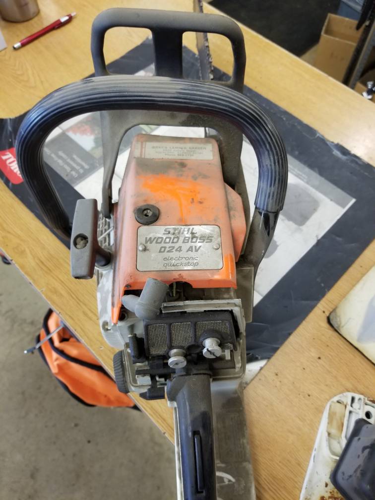

The air filter is pricey for a 024, last time I bought one for mine it was like 35$ for that little filter. Probably cheaper and better flow to upgrade to 026 setup?

The air filter is pricey for a 024 last time I bought one for mine it was like 35$ for that little filter. Probably cheaper and better flow to upgrade to 026 setup?
Not sure on that. I still have an air filter but it's in pretty dire need of a good cleaning and inspection for damage.
Mine looked exactly like that. Flocking wears out over time I think. The newer ones are improved but I don’t like the price. I think you need a 026 filter cover to upgrade to the larger filter. Maybe you could find a good used setup for cheap?

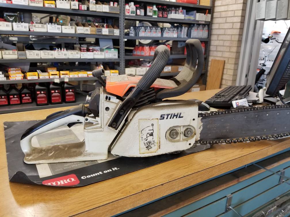

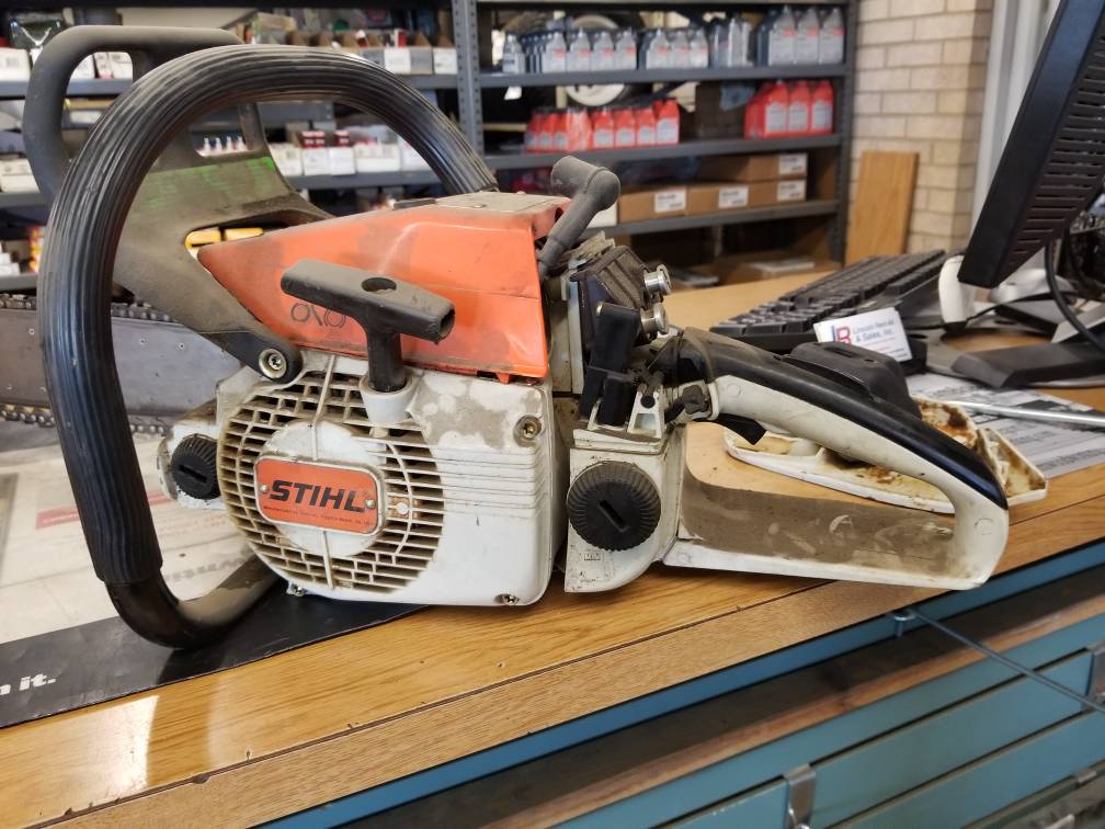

Well it's about time Joe! Looks like I'll build one right along with you! Stopped at Ted's aka @big t double shop this morning before I headed back to Pittsbrugh. Was looking to snag some parts off of this saw. Ended up taking the whole thing for the price of a cheap case of beer! Lol! Dead saw salvage coming up!
That is a super nice find. I'm gonna want to see it when you get it cleaned up -- I believe it's gonna be a cream puff.
The filter will have to be replaced by the looks of it. How about the piston cylinder?
