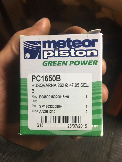

I sent a 262 jug to @drf255 to machine for me, and he told me it was a "B" cylinder, and I needed a "B" piston. This is the first I've heard of this. Fortunately the meteor piston I bought was a "B" piston.

The meteor box on top measures 47.95mm. So you should get .05 mm of side clearance or roughly .002"-what we all look for. I can't find a pic of the A piston box I had, but I will try. It's a slightly smaller dimension to fit into a slightly smaller cylinder.
At these tolerances, compression would be the same with the wrong piston. But a smaller A piston in a C jug would be loose and slap the skirts, and a B piston in an A jug may seize if it expands too fast.

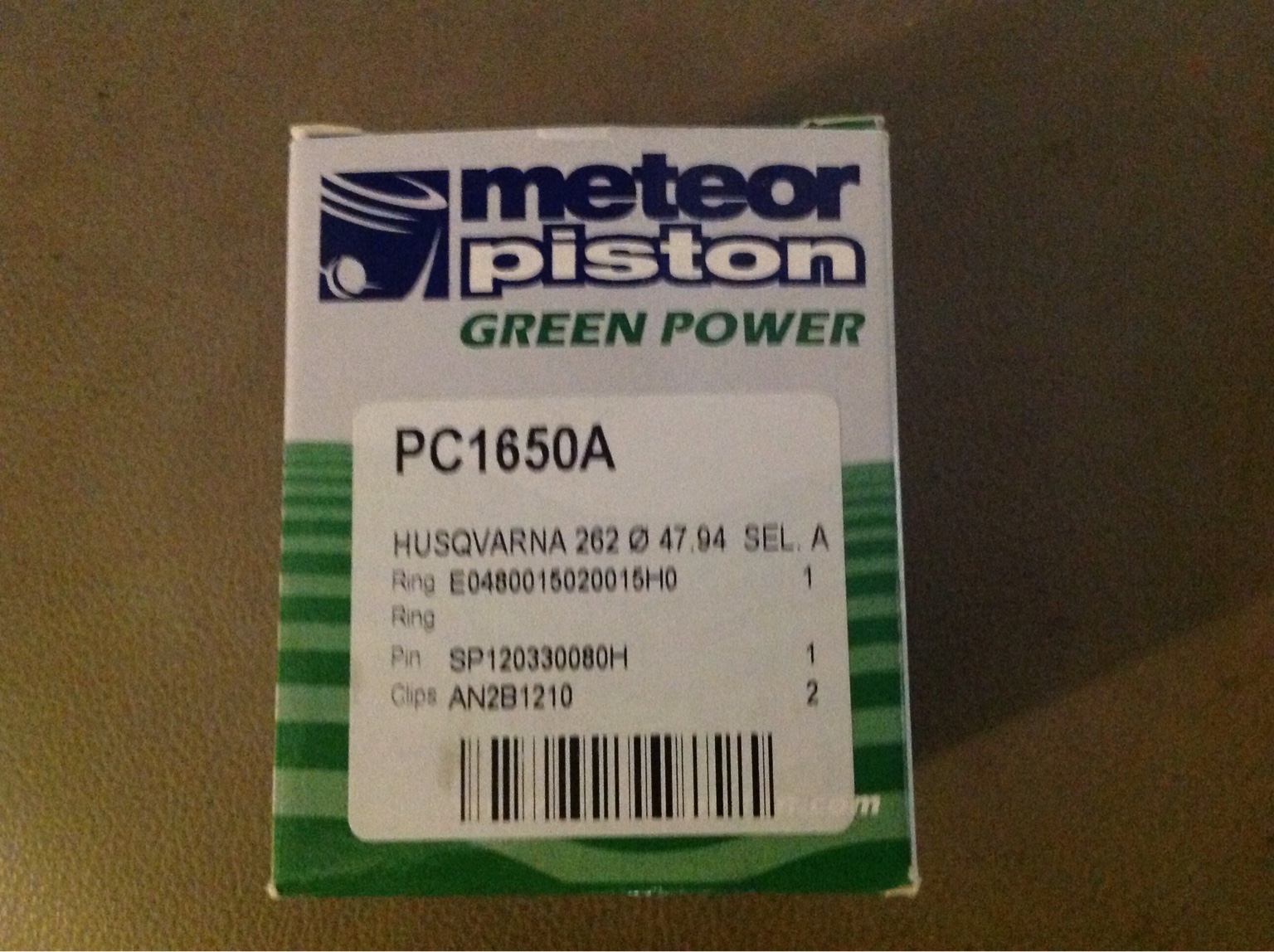

Found my 262 "A" piston box.
So the piston is .0004" or .01mm smaller. Is that enough to cause an issue? I have no idea.
There has to be a reason that the OEM bothers with it I would think.

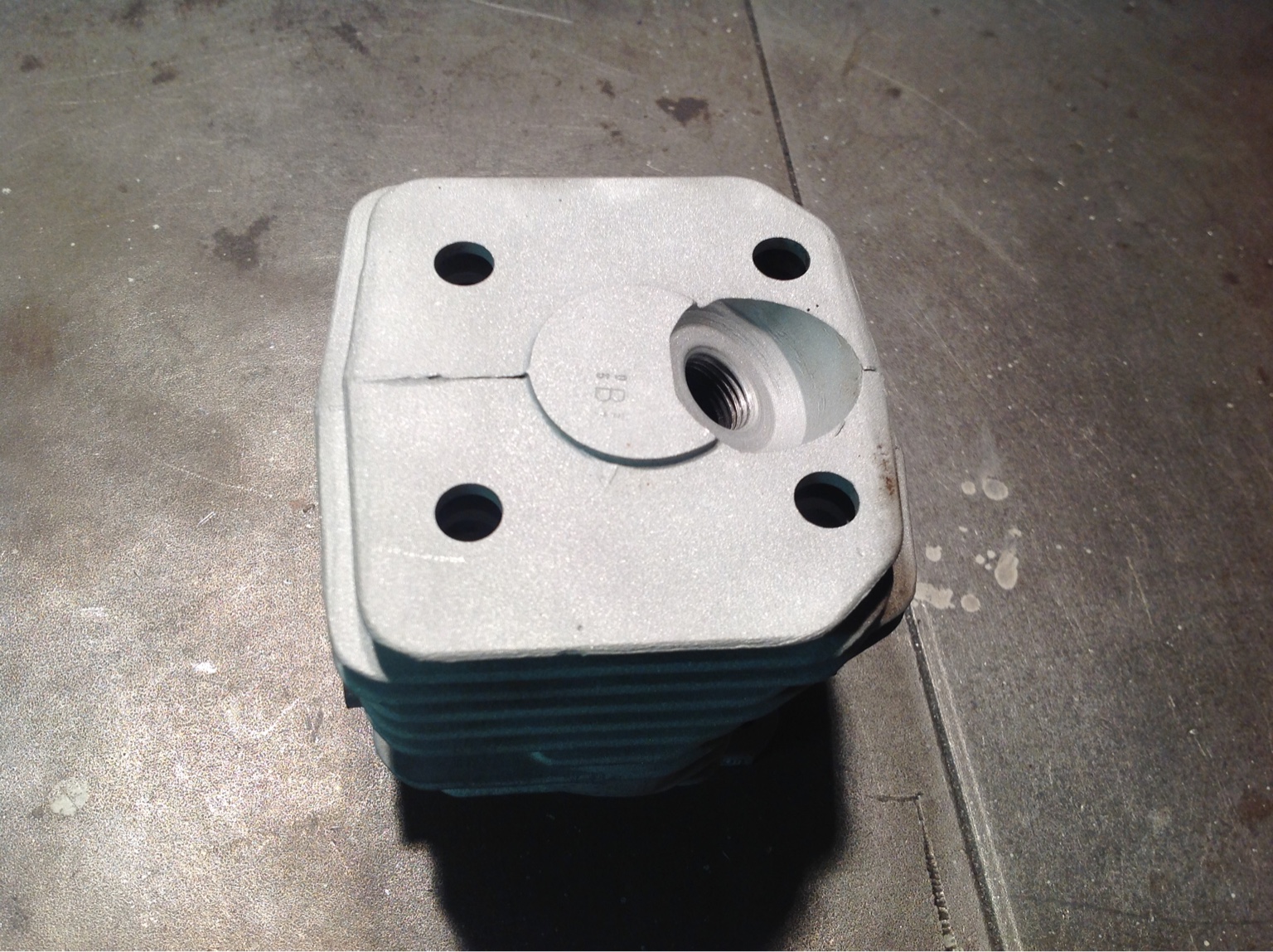

Dave, you dont need to tear them apart, take out the spark plug, Meteor A B marking is right there on that spot
