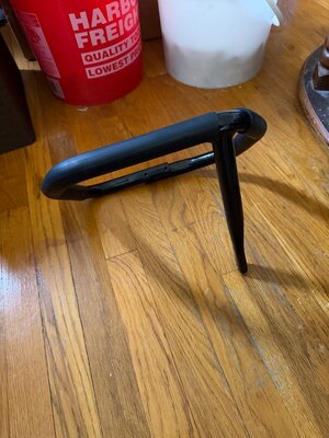

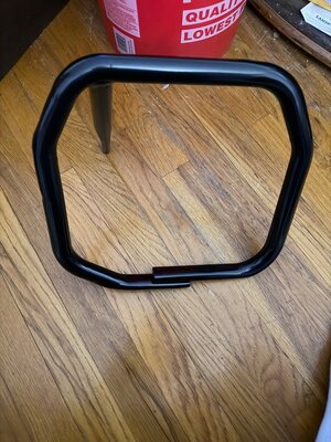

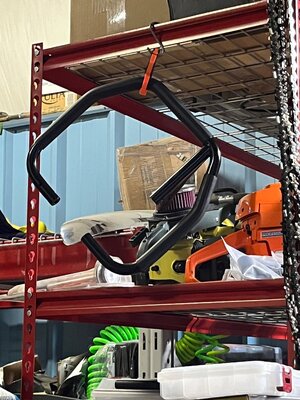

Get a lot more than you need to get it on
I pressurize the hole 33 ft too put it on then cut it off as need once on

Very nice, unfortunately this isn’t my first rodeo with this stuff and the full wrap on a 090g is pretty open and forgiving. Only need a smaller chunk

090 full wraps are some of the worst handles to install hose on
Takes 2 people to hold it abut no place to grap it because new hose goes there

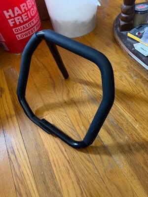

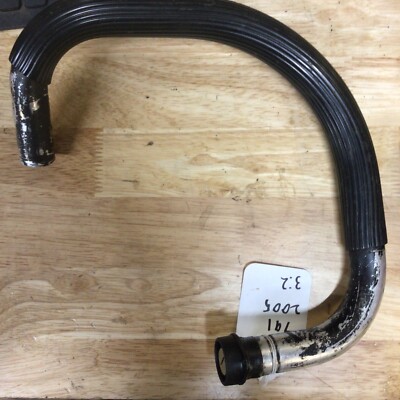

Well. To prove a point i ended up ordering about 4ft of some Tubing from a shop in Washington. They had a left over section that they sold Me cheap. Once here I boiled some water, added soap. Dunked it in for a while and what do you know. Goes right on. Once the hot water and soap starts to evaporate and dry up you just use some shop air and get it the rest of The way on. Again. Easiest handle I’ve done with all that open space. No waste and certainly don’t need 30ft to install.
