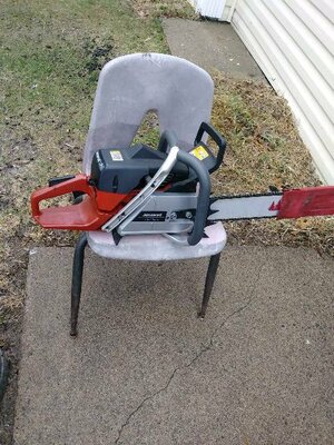

Anybody know if the 572 handle fits the 272 or 288’s
sixonetonoffun
6:07 PM
4881
Dec 25, 2017
311
861
MN
Necromancing thread 3 yrs WTF?
I put one on one of my Jonsred 2065's it's a low one piece top cover. Took a little tweaking and sits 1" tighter on top so no humongous mittens. It balances slightly nosed down from top and absolutely perfect from the clutch side.
Why? Because it was there. Actually happy with the result. Plans to put a 52mm p&c with a Tillitson HS299 carb. Just never get around to it.
