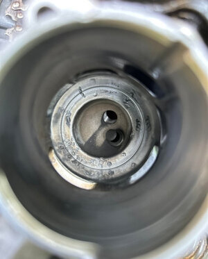

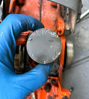

Hey guys,
Just rebuilt a 555 over the weekend, I threw a 562xp intake on, and would love to add the transfer caps, and a top cover that fits correctly. Assuming these parts are coming from a blown up parts saw, I also need the buffer bolt/bushing between fuel cap and purge bulb.
For those curious, the decomp failed, dropped a piece of itself down into the cylinder and it got smashed a hundred times between piston and squish band before it quit. Planning to do a muffler mod, the transfer caps, and maybe some machine-work-free porting. A cylinder clean up and meteor got her running third pull.
Thanks all!
Jake

I'm always really interested in mechanical carnage and trying to understand the why, best I can figure is there was a piece of flashing or a part of the assembly that finally dropped in.
Fortunately, the little craters mostly went up into the squish band, and didn't push much of any of the metal up (down towards the piston). I used a polishing wheel on a dremel to pull the slightly proud edges back down, and pushed on the hone just a little into the squish band. Did that help performance? No. But the alternate was trashing a cylinder, or sending it out to get on a lathe when the saw isn't particularly clean or valuable to me. Seems to run plenty well now!
Glad to know I'm not the only person who has had something fail like that, where it's P&C mashing something together rather than a lean condition or failed seal.
