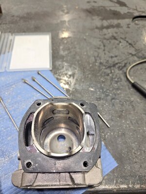

So the saw is going back together 100/119/77. Curious, should I lower the intake floor a hair to try and get 78 maybe 79? Would it be worth it?
I would. I'd widen the exhaust to the limit as well.

Thoughts on Meteor cylinders? My presumption is they'd be pretty good aftermarket.... I like their pistons at least
Toughest cylinder I've come across, is more difficult to work over. I consider it the best AM replacement cylinder option, especially for stock saws, or mildly built ones.
I always tell the story of the 660 that came in with one that broke the top ring off and chewed it up and spat it out. The top of the piston looked like the surface of the moon, the cylinder, not so much as a scratch on it.
The only one I ever fully ported; I bent the boring bar and wrecked the tool holder trying to machine the squish band. I really had a time trying to get a carbide cutter to get through the plating when porting and even the aluminum was tougher and harder than any OEM cylinder I've come across.
I recently put a 357xp Meteor P&C kit in my 359G saw that I have. OEM stock has dried up and the few that were left are going for more than the whole saw is worth. I just set the squish by turning down the base and ported out the exhaust port without getting near the cylinders edge and left the rest alone. The saw runs plenty good like that and am happy with it for a firewood saw when heated handles are desirable.

Right on perfect good to hear some first-hand machining experience. I feel ya re: OE cylinders.. they are getting hard to find (for the older saws) and are STUPID expensive... i'm going to be in the market for a 372 jug and it's nice to know I could confidently just get a Meteor product and move on with life. Give Wolf Creek some business and just cringe over the exchange rate haha
If a used OEM cylinder can be sourced reasonably, that can be a good option too, just buying a new piston.
I look at it this way, a piston is one of the easiest parts to make, a cylinder on the other hand, is one of the hardest.

Roger.. good used is certainly ideal, and I've thrown meteor pistons into lots of old cylinders (kinda my go-to "rebuild" process). i've unfortunately had several negative experiences buying used cylinders, folks generally lie about the condition and deliberately provide images which don't represent damage. i've learned my lessons random strangers can't be trusted and if I were to do it again I would specifically wait and deal only with a very reputable and visible forum member. Mia Culpa. anywho don't mean to derail the thread..., it's great peak performance shared with us some of his timing numbers.. he's in my province somewhere so maybe i'd ask him to do some porting for me. i think a ported OG 372xp is about the best rig for all-round work a guy could ask for.
