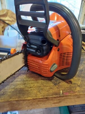

Here's a 346xp hybrid I did that had the impulse blocked, easy fix but a PIA.
Yeah its very similar to how this is behaving, will run and cut great for one cut or so then start dieing. If I idle for about 15 seconds it will crank back up again and do another cut only to die again.
To add an extra wtf, if I open the gas tank cap and close it again it will crank back up straight away. Which is why I was chasing tank vent and fuel line issues for a bit. I've replaced the fuel lines and added a echo vent and also rebuilt the carb with a kit to try eliminate this.
Looks like I'm taking the top end off again!
