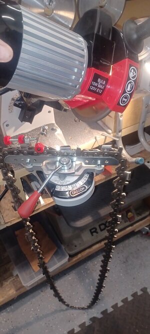

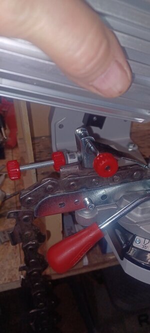

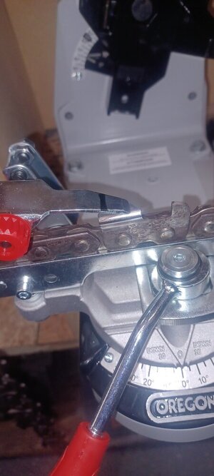

I got a new 530 and it works great. It is just the new version of their 520 but with a larger carriage for the big chains. I also got the smaller 520 jaw kit to be able to do rakers on regular chains so it replaces my cheap Vevor.
I did have to modify the chain stop...I think somebody goofed and put the 520 version on it. Easy fix, cut off 3/8", works now.

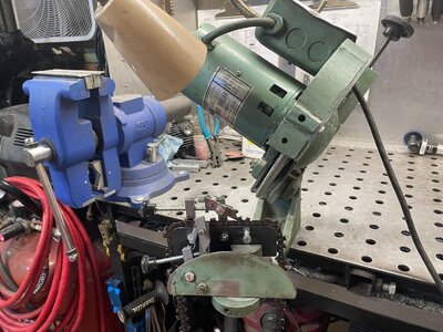

Iowa City
Here is the Silvey P&D I have. I made the 510 style table for it so you can grind regular chain with it as well.
