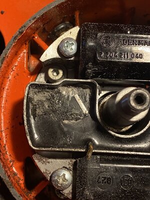

Here ya go with some pics and here’s a link for the capacitors.
Soften the potting with a heat gun, hair drier and then you can pick it out with a pocket screwdriver. Clean down to the circuit board here. IMG_4787.jpeg
Now, cut the trace and remove about 1/8” of it. This removes the faulty cap from the circuit.
Now solder a wire to that long trace, make it long enough to reach your capacitor (where ever it’s mounted).

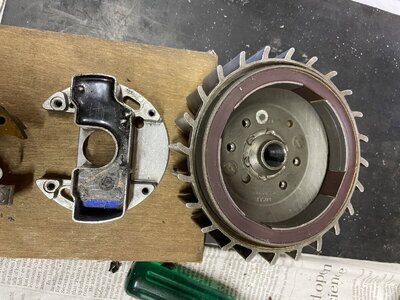

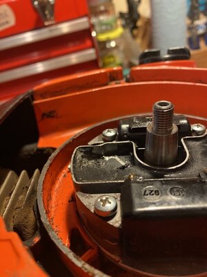

Thanks a million. I have exposed the track on the circuit board. I did not proceed as I saw no way of removing the capacitor. I have now seen your photos and description and it all seems plain sailing. See progress so far. Interesting if you remove the woodruff key you can spin the shaft easily to see if you get a spark. I will come back when the job is complete. Seth 8837

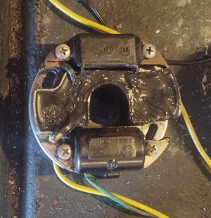

One extra Visio. Seth8837

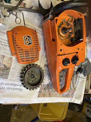

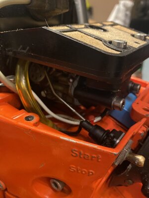

Just an easy question to answer. What saw are these pictures of. My saw is a Husqvarna 285CD and the crankcase is different see photo. Seth8837
Jim and I both have made this repair recently and his pictures are of a dolmar 123. It is the same ignition though. If the cap didn't fix it I think you are in the market for a new ignition. I have seen the repair not work on one ignition could be something else failed besides the capacitor in this one
