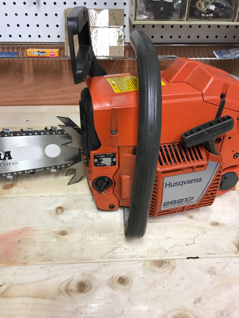

I have some patterns I mocked up... I kinda wanna keep mine somewhat factory looking for a 2-series. I think this particular saw is a 254xp.

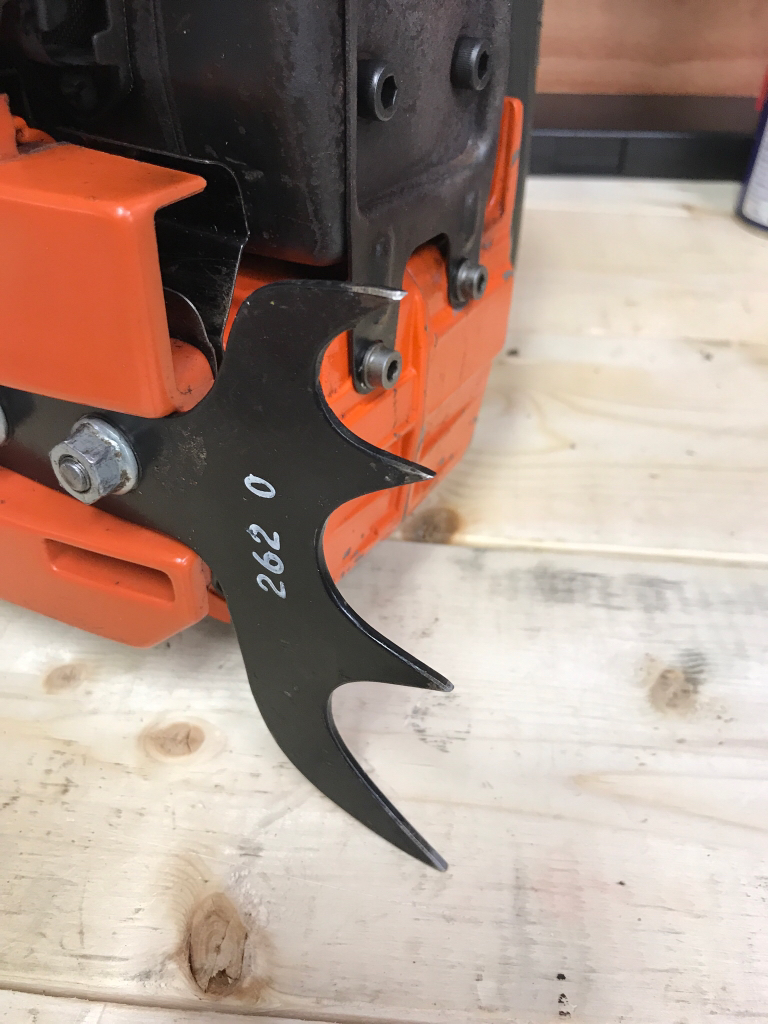

Somewhere in the past I picked this one up. No idea when or how..but it’s similar to what you guys are talking about...and I don’t have the matching inner.
That's the "Pro Safety" brand outer dawg. They were sold by Madsen's for years until Pro Safety stopped making them. There was also an aftermarket full-wrap handle for the 262 available for many years.
Now that’s cool to know. Great info, thank you sir.

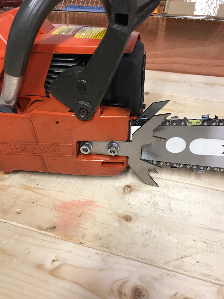

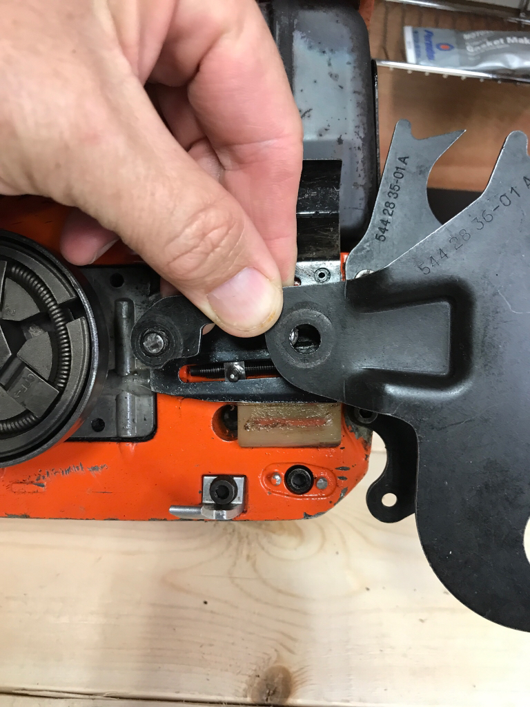

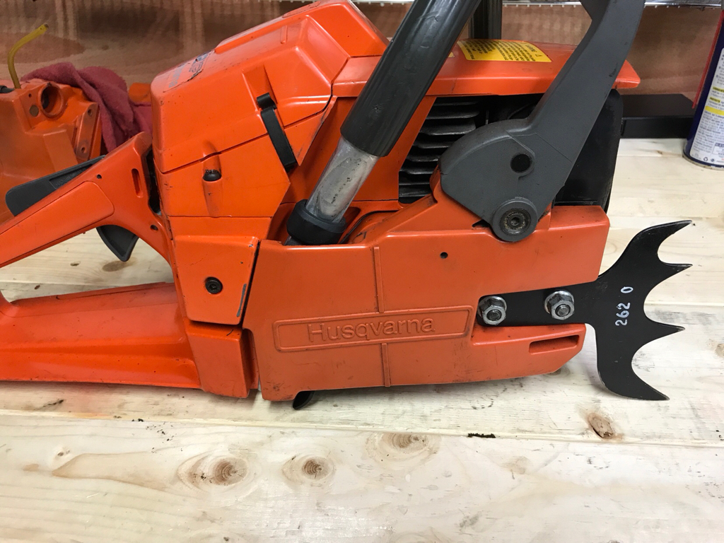

Picked up a set of standard 372 dogs from the dealers junk pile the other day. After I got the inner dog modified to fit my 262, it made the juice not worth the squeeze on making the outer dog work. It would have to come up a full bolt holes to be even with the inner. All said and done I'm happy with the 372 inner dog. It will better protect the muffler in those situations when the muffler gets mistakenly used for a bucking dog. All the modifications were made to the lower mounting bolt area to make it work, even was able to use the roller chaone catcher but I had to shim it out with two small washers so the roller base wouldn't be pressed against the case. IMG_20180421_181523678.jpg IMG_20180421_181532065.jpg IMG_20180421_182252213.jpg
