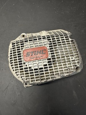

Frognc97 Well-Known OPE Member Yearly GoldMember Local time 3:23 PM User ID 33189 Joined Jun 3, 2025 Messages 25 Reaction score 32 Location Charlotte nc Yesterday at 2:52 AM #1 Trying to find the correct recoil cover. Flywheel number 1122 400 1209, recoil cover I have is 1122 084 1005
Brad Button Super OPE Member Local time 12:23 PM User ID 4979 Joined Jan 6, 2018 Messages 108 Reaction score 212 Location Angels Camp,Ca. Yesterday at 12:45 PM #2 My IPL shows 2 covers, 1122 080 2110 and 1122 080 2102. You may need to find a service manual to see which one you need.
tree monkey Mastermind Approved! Local time 2:23 PM User ID 339 Joined Dec 14, 2015 Messages 4,840 Reaction score 40,148 Location wi Yesterday at 8:02 PM #3 none of the part numbers given are in the current ipl. any 066-660 rewind should interchange. i believe you have an 064 rewind or 064 flywheel
S singinwoodwackr Well-Known OPE Member Local time 1:23 PM User ID 34279 Joined Sep 14, 2025 Messages 44 Reaction score 128 Location moon Yesterday at 8:36 PM #4 Early and 064 covers are skinny. Later 066 are fatter. Parts numbers for 1122 are ll over the map I have several and can get pics if needed 1209 shows as a 066 Attachments 064, 066 FW bulletin .pdf 064, 066 FW bulletin .pdf 303.3 KB · Views: 6 Last edited: Yesterday at 8:50 PM
jacob j. Only the weird Staff member GoldMember Local time 12:23 PM User ID 232 Joined Dec 24, 2015 Messages 9,485 Reaction score 65,743 Location Coastal Oregon Today at 8:57 AM #5 singinwoodwackr said: Early and 064 covers are skinny. Later 066 are fatter. Parts numbers for 1122 are ll over the map I have several and can get pics if needed 1209 shows as a 066 Click to expand... Yeah the 1209 is the red-light 066 flywheel. This would be the starter housing they originally came with: GENUINE OEM Stihl 066 Ms660 Recoil Starter Assembly Pull Start Used. | eBay Used in great shape needs new elastic-handle and rope www.ebay.com
