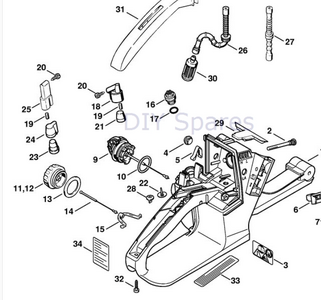

Are the older tall Stihl tank vents serviceable? Or do you have to buy the whole unit?
Any alternatives to using other tank vents?

If you're talking about #25 in the attached picture, it doesn't have any moving parts and rarely fails.
There's a red rubber one-way check valve that goes in the tank (#22 in the diagram) that works in conjunction with #25 and that
part fails often. They're available on eBay as Holley carburetor check valves for fairly cheap.
