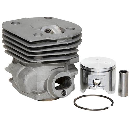

Yeah. The bad mistake they make is writing it is a replacement for el42. That gives ammo for customer.
I was just writing a question to eBay.de seller about venturi diameter of their 357/359 carb. Hopefully finally found real 17mm for my 353 testbed. Was lucky to buy saw for 70$ so can spend some for toys. OEM 353 and 346XP NE PC-kits seem to be hard to find. Is this only US since there seems to be some stock this side of the pond?
No they have been difficult to find here also. I don’t know if Husky stopped making them or if it’s another Covid shortage

And Duke's 353 version x was the best equivalent. Just solve x. Cause I do not know.

Anyone give me advice if OEM kits get even more difficult to find.
I prefer mid rev grunt more than top rev peak power. So which one of those many options should I get???? And now we are talking about Duke's webshop items.

It’s not the cheapest thing out there, but meteor is one of the aftermarket’s I trust the most.

I’d prefer oem 346 like most people probably would. 544142908 is the part # for the oem 346 p&c. If you google there’s some dealers showing them available. Looks like anywhere from 140-180ish. Whether or not they cancel your order because they actually have it available I am unsure of.

Yeah, codes are 08 and 07 in the end. Do have to check availability before placing order. Cheapest in Europe are around 200$ or bit less.
