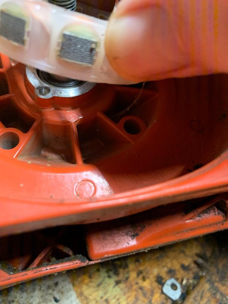

Maybe I can post this in the proper place this time.
I have a parts saw 5105 with heated handles. It has the White coil on it.
If I want to install these heated handles on my 5105 with a black coil and Easy Start, do I have to bring over the White coil with the flywheel, or just the flywheel alone, and change the starter pawls?
Thx!
exSW
'Cause Thomas is a poopyhead
11:51 PM
109
Dec 23, 2015
5,072
16,690
United States
Thx!
Check and see if the flywheels and magnets index at the same spot relative to the coil.
Fishnuts2
10:51 PM
284
1,024
5,947
SE MN
The flywheel is about a half magnet width different. So, it needs the White coil to be timed right. But....the stator mounts are drilled and tapped to the chassis and the non-heat chassis is not. So it looks like my project is stymied unless I want to build around the parts chassis that’s been scrapped for other reasons.
