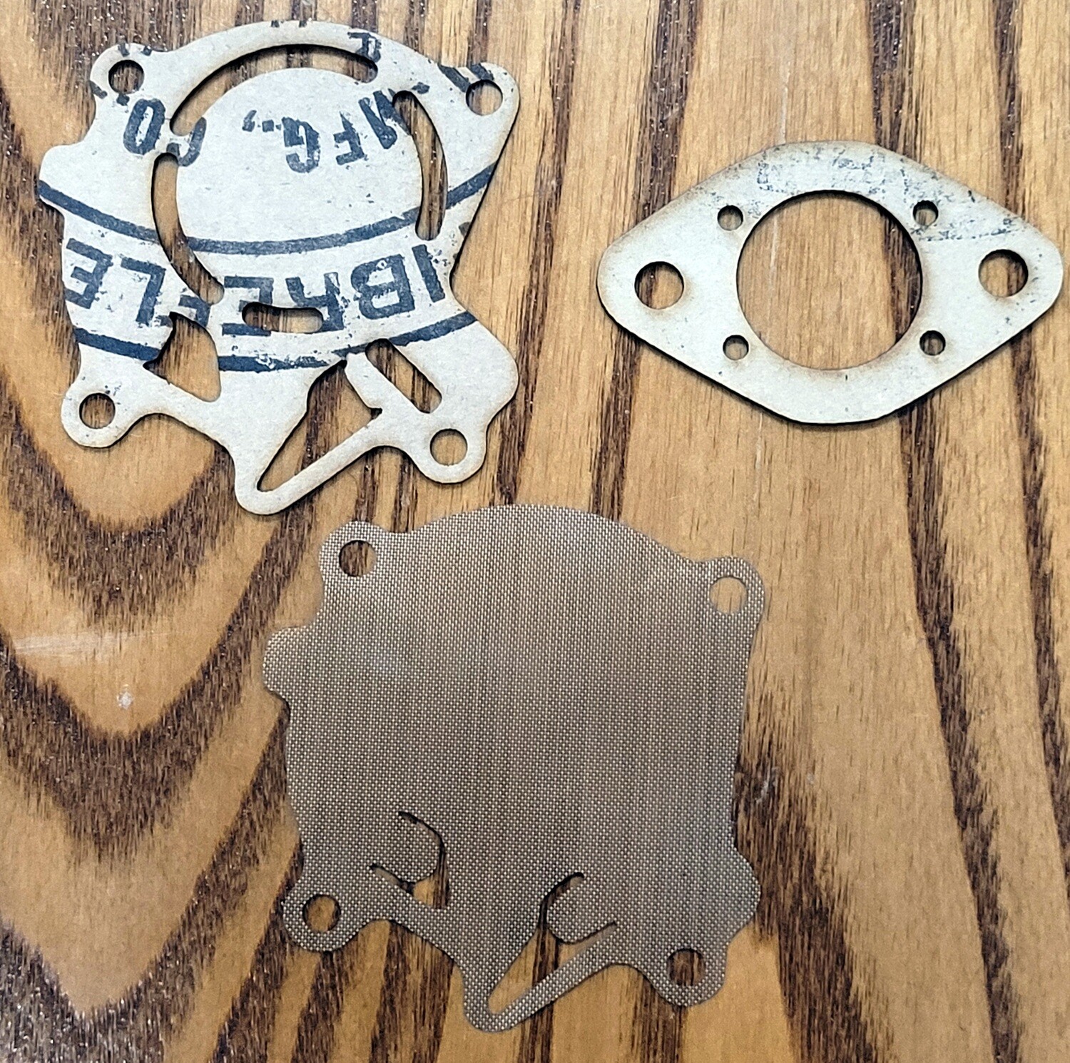

Just released a new (Tried and tested) kit for the early flatback also known as a Mac-5 which is different than the typical.
These are used on the D30, D36, 1-40, 1-50, 1-60, 640, saws
Bryan Gray did a nice video on prototype installation and testing:
The port he noticed missing has been added even thought it ran just fine without on the prototype he tested.
Not a common carb, but I'll be keeping them on the shelf and ready to ship.
