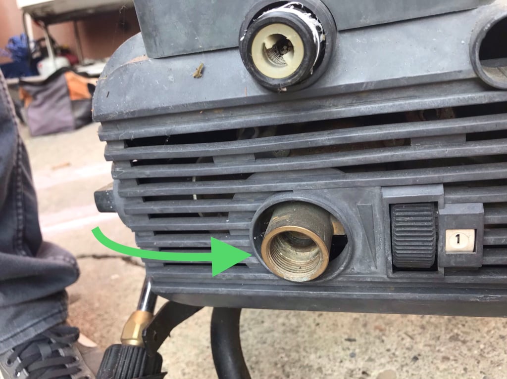

Hi everyone, I’m new to the forum and need some help
I have a Stihl RB 220 K pressure washer.
It’s missing a part that goes from the pump to the pressure hose . Not sure what’s the correct term [emoji1744]‍[emoji3603] quick connect or coupler [emoji1744]‍[emoji3603]
I already went and check Home Depot,ace and dales hardware which has a stihl department and had no luck.
The m22 quick connect from Home Depot seems to be a mm or cm too small.
DND 9000

I think you mean the hose connector with part number 4719 700 7300.
