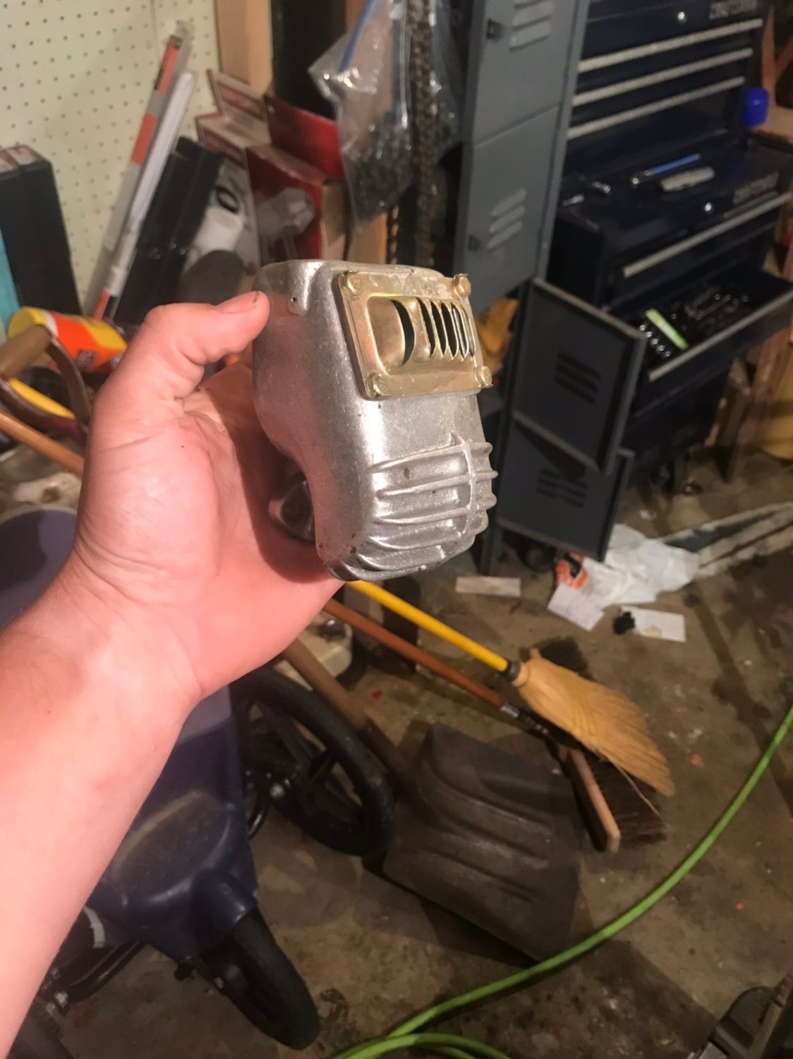

How is this for a muffler
I think it’s Chineese though
This one is the original
Sucks the fins are gutted. But it looks like it has a muff mod already.
