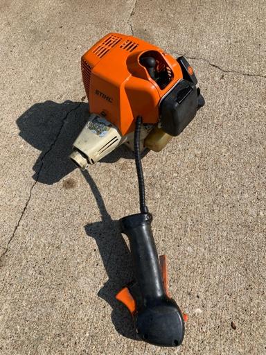

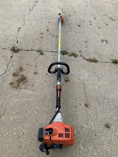

Stihl runs again.
FS90 shaft + FS75 engine + Farmertec head = shorty pole saw/weed wacker.
New top ring on the piston and base gasket delete. Feels like it has a touch more torque.
Now to rebuild the HT75 with the leftovers. It needs crank seals for sure.

The HT75 engine is back among the living.
New aftermarket top end, crank seals and base gasket delete.
Some awkward running it sans pole but the bearing in the clutch housing is dry, so waiting on a replacement.

what kind of pull is it to start? good and snappy?? Do you think the delete bumped the compression on a new top end?
67L36Driver
3:07 AM
596
9,404
39,387
About as snappy as 25cc gets I suppose.
Stands to reason, removing .020” has more effect on a 34mm bore than a 48 mm bore.
