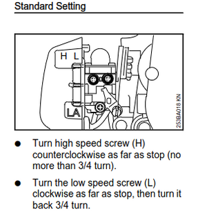

As noted from above, you may need to adjust your new carburetor. Sometimes it is best to reset it and adjust from there.
Here is the information from the HS 45 Manual

Thanks. Adjusting both low and high speed screws, and then setting idle seems to have done it. Appreciate the responses.
