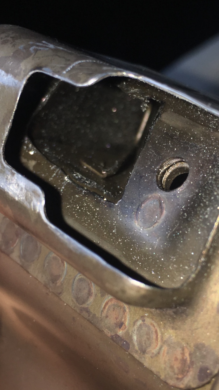

So I'm finally getting around to doing the muffler mod on my NON mtronic 261. I cut the gills in the left side of the muffler, took out the screen also. Is there any more that should be done?
What's the consensus?

Does that look like enough?
Not if the channel feeding the screen wasn't cut open, removed or partially removed. A ball burr is about the best tool to use for this. You grind a hole through the channel where I have it marked. I don't like to grind it open too far forward because the deflector won't be able to direct the flow. 20180101_153658.jpg

Not if the channel feeding the screen wasn't cut open, removed or partially removed. A ball burr is about the best tool to use for this. You grind a hole through the channel where I have it marked. I don't like to grind it open too far forward because the deflector won't be able to direct the flow. View attachment 104542
Are you saying the channel that the screen sits in needs to be removed?

this is what i did to the muffler on my 261, and then reset mtronic, can anyone see any issues doing it this way? thanks

YOU MAY GO DEAF!
But how does the saw run?
Any vids?
