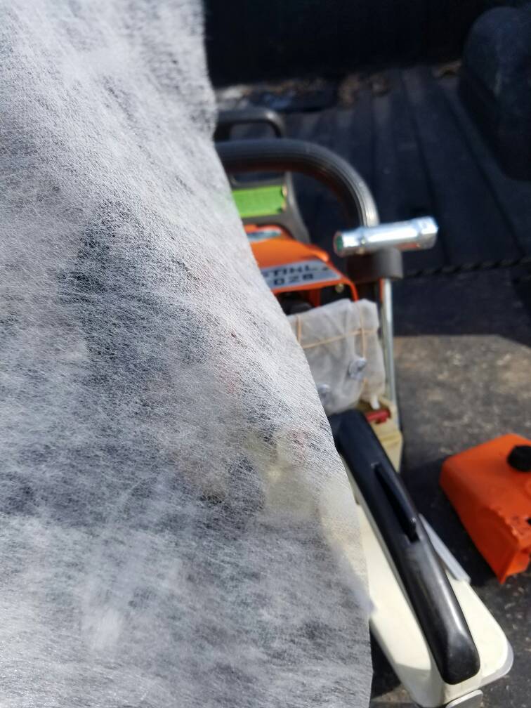

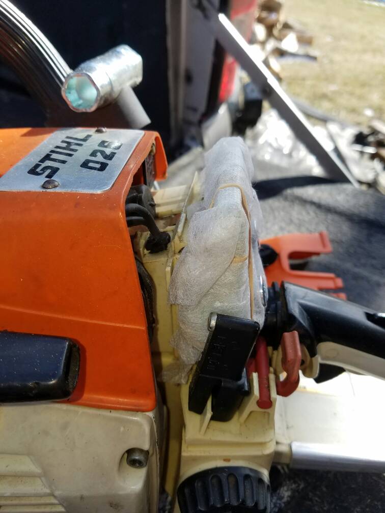

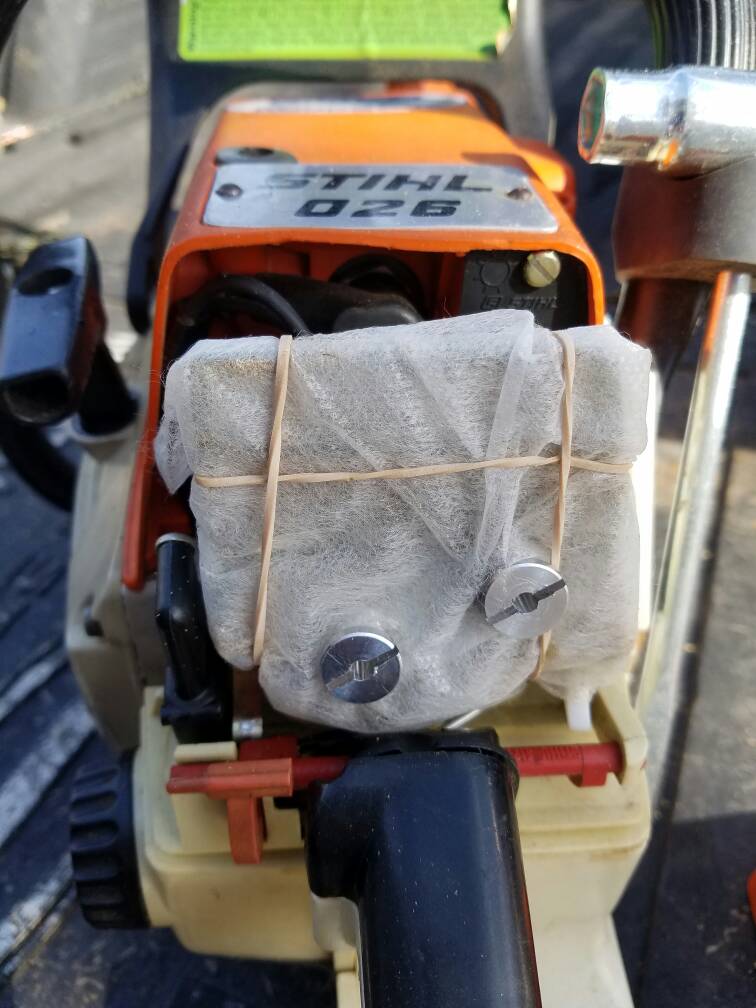

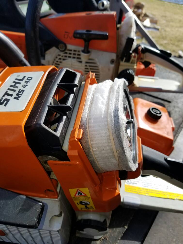

This is the thin barrier that I was talking about.
I threw a pic of my 440 to show the wrap as well.
Not sure how good it really is, but it makes me feel better. I can breathe right through the barrier without restriction.
Is that the outer wrap of a tampon? My eyes are old and bad :goofy::goofy::goofy:

earth
Lol. Don't know, never saw one. Lol
It is landscape water barrier that is used to put over crushed stone. Allows water to flow through, but stops the dirt from flowing through it.
