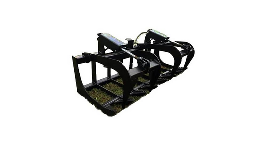

1708609322265.pngLooking at grapples and was looking for advice on choosing the best attachment for picking up logs. I am leaning towards this one.

What sort of machine will you be using it on ? I purchased a Virnig V60 tine grapple and it’s an absolute beast.
I’ve used it on my S185 ……
It’s happiest on the S300 though and I haven’t been able to destroy it yet. It weighs 1,400lbs and was $3.75/lb lol.
On the Deere 2038r I went a different direction and got a set of pallet forks and an add on grapple. It’ll get used to hold wood up so I don’t have to bend over to cut it to firewood length and I’ll use the skiddy and grapple to do anything this in incapable of. This is a stock photo, not mine but is just like this.

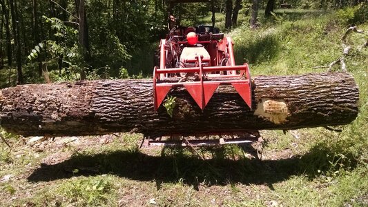

View attachment 408722Looking at grapples and was looking for advice on choosing the best attachment for picking up logs. I am leaning towards this one.
You don't need a 60" or wider grapple to pick up logs. In fact, the heavier the grapple, the less the log you'll be able to lift and carry.
About 7 years ago, I planned to buy a 60" grapple for my ~40hp Kubota; they were out, but they had 48" and 72" (and up). I knew 72" was too big, so I got the 48". Never regretted it. I know I would have regretted getting a larger and heavier grapple.
Heavy loads:
This giant Shagbark Hickory came within 4" of hitting our house. This is as far as I could lift this log; the tractor simply wouldn't lift it any higher:
The trunk of a Maple I took down the other day; most of this tree went to my BIL.
I hope this helps.
