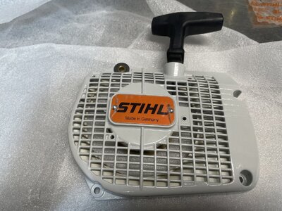

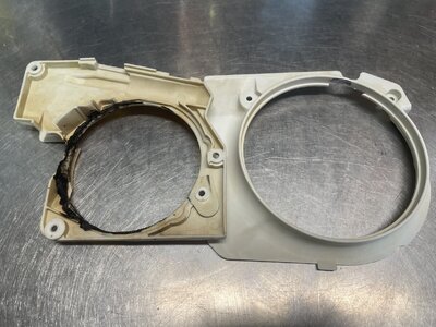

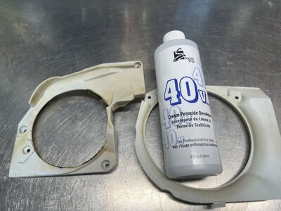

I ran accross a YT video of someone using this 40V peroxide hair cream to remove stains in some white plastics and I thought it would be great on some old Stihl 064 plastics I have for a full restoration.
You just paint this stuff on and let it sit in direct sunlight. Reapply till you see the result you want.
I didn't get a before and after but I didn't treat the backside of the chain brake cover so you can see how much better they look.
Assembled it looks great!

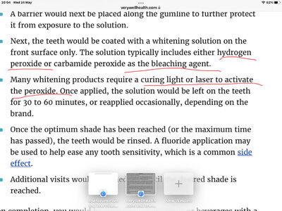

While eating dinner, I had a brain fart.🤷‍♂️
Teeth whitening at a dentist 🤔
How do they perform the task ? My understanding is the same what we’re doing here, the uv light is the activator ( is that the same as a catalyst. Takes part but is not used up in the reaction)..
edit I’m probably wrong in comparison to the activator/catalyst. It was a long time a go but I have a feeling the activator supplies some thing where as the catalyst is still there
