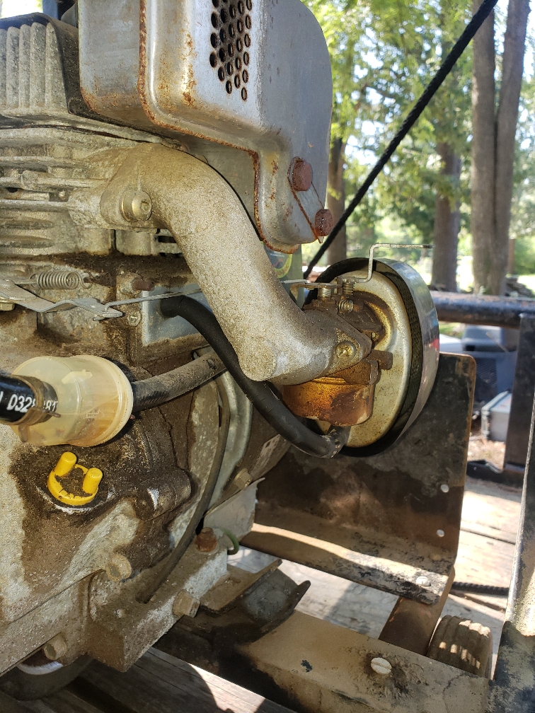

I have a Coleman maxa 5000 generator with a Tecumseh 10 horsepower motor. I recently left it a few days in my pasture. A thief stole the gas, left fuel line undone, also left his knife. Also stole gas out of my logsplitter. I hauled my gen out of there. I noted that there was still a bit of gas (I assumed gas!) in the tank, which I thought was odd but what a dummy, I added some gas because I needed to use the gen soon thereafter. Would not start and been running great. I finally suspected water in gas and confirmed it was. Drained best I could and got it running. After he stole the gas, did the thief dump water in the tank? Or can rain water enter through the muffler vent holes? I can't see how that much rain could get in thru the tiny vent hole atop the gas cap. BTW my pasture has locked gate. I assume it was a local who climbed the gate or fence at night.
We might have had a brief heavy rain at the pasture. I got one inch in town.
Another question... see the rubber tubing going from the air filter housing to the engine... what is this called? I have ideas but unsure. Can I buy a piece at a hardware store or must I buy the exact part. I note it is cracked, dry rotted at the bend. TIA!

That's just a breather tube. I would replace with something from the hardware store. It's for positive crankcase ventilation.
On a yamaha snowmobile I made a custom turbo setup for, I replaced my breather tube with a little air filter as my airbox was turned into an intercooler and didn't want to reroute the breather tube to the air filter at the rear of the sled.

That line looks like the crankcase vent tube. It looks like regular fuel line and should be easy to replace. Any air entering through a cracked line would allow unfiltered air into the carb.
