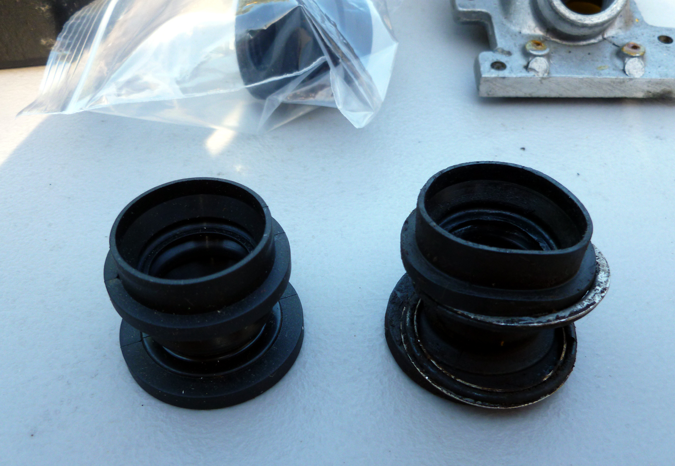

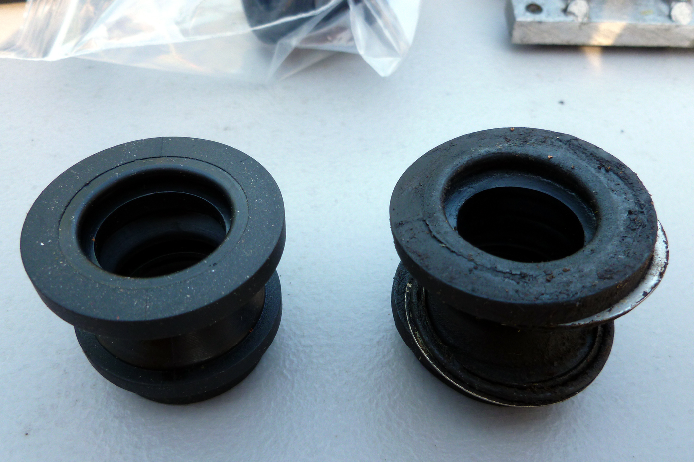

At first glance, this is a nice part - the texture and flexibility of the rubber is great, and it holds its shape well. My experience has been that a lot of used intake boots are deformed due to fuel exposure and heat.
As delivered, the new Traverse Creek part on the left - old used part on the right.

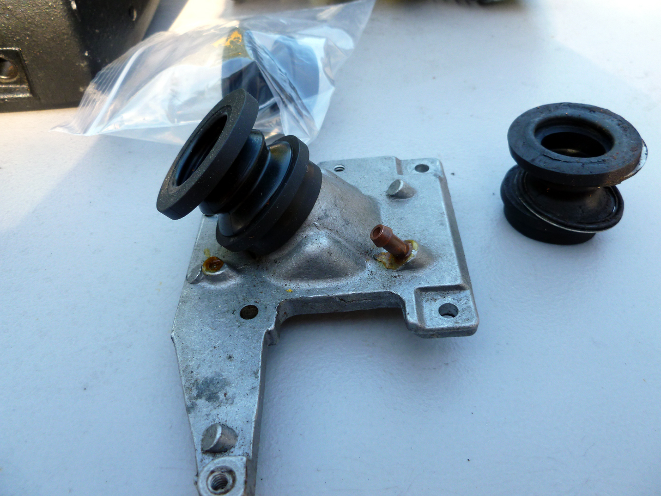

These boots install on a flange under the fuel tank/rear handle assembly, and then slide down and "snap" on over a lip on the intake manifold. I've found old boots leak more at the junction
with the intake manifold usually because the lip where they install on the tank is quite thick and usually maintains a tight seal. The new replacement boot installs well on the both the tank
and the intake manifold - when I installed it on the intake manifold, it gave a very satisfying snap as I locked the sealing ring of the boot on the lip of the intake manifold.

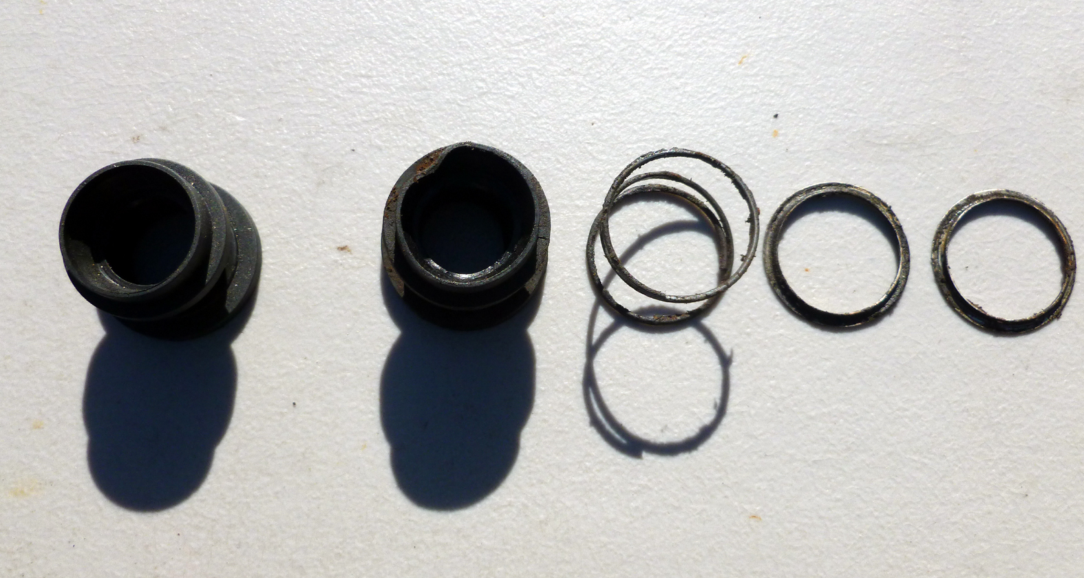

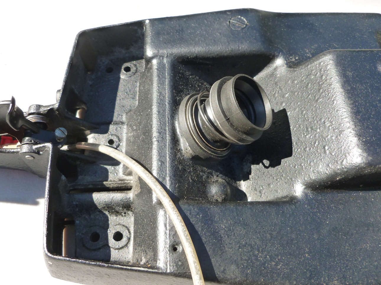

As a part of installing the new boot, you'll need to transfer over the intake spring, which applies pressure to either end of the boot, and the two collars. These parts help maintain the seal
between the tank and the manifold. Usually these parts clean up easily and take a total of about five minutes to remove from the old boot and install on the new.

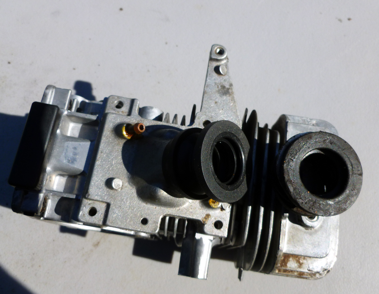

Uncle Lee (@Lee H ) mentioned one time that he uses STP oil treatment to help slide the sealing ring of the boot onto the lip of the manifold, and I've found that to be helpful.
Overall, this is a great product, and will prolong the life of these great saws. Here's one in a runner:
