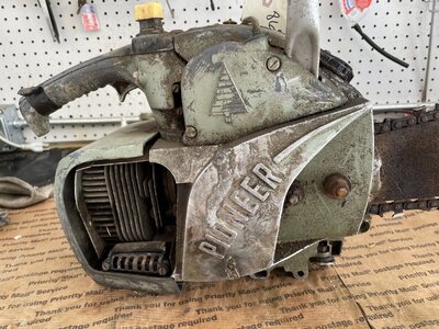

Good morning, any manuals available for a Pioneer 450 chainsaw?
Thanks

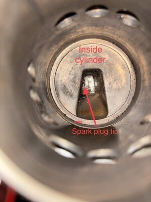

Thanks for those manuals, a little background here , I picked this saw up at a flea market, going to hopefully restore it. The one major problem I have found so far is that the threads for the spark plug are stripped out although the plug does tighten up, any thoughts?

ray benson
5:12 AM
1239
May 4, 2016
5,578
31,212
nw indiana
I haven't dealt with that problem. Quite a few kits on amazon. Best to ask in the chainsaw forum.

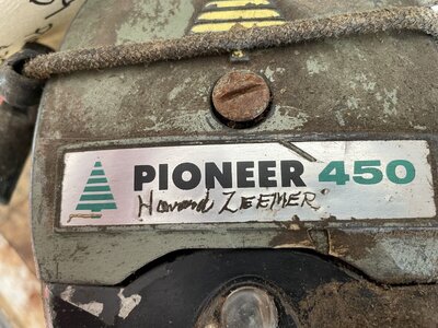

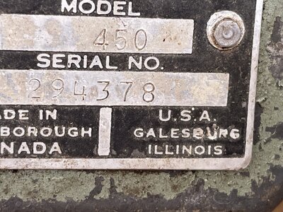

Hi All, how can I tell the age of this saw, also do the gears that engage the flywheel get lubricated?
Thanks
nbbt
5:12 AM
12238
Apr 13, 2020
2,220
13,161
5543X, 5644X
IIRC @srcarr52 has done repairs by welding up the fubered hole and remanufacturing such that it appears factory fresh.

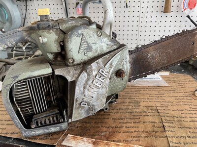

Good morning, all set with the insert, now I need to make a head gasket and an exhaust port gasket, looking for recommendations as to what material would be the best choice and least expensive.
Also just found out this is a rotary valve type engine, never heard of that before so I am leaning something new.IMG_3854.jpeg
Also just found out this is a rotary valve type engine, never heard of that before so I am leaning something new.View attachment 394522
Attached is the full Pioneer shop manual. Pages 3-4 have some info on the rotary valve intake system.
