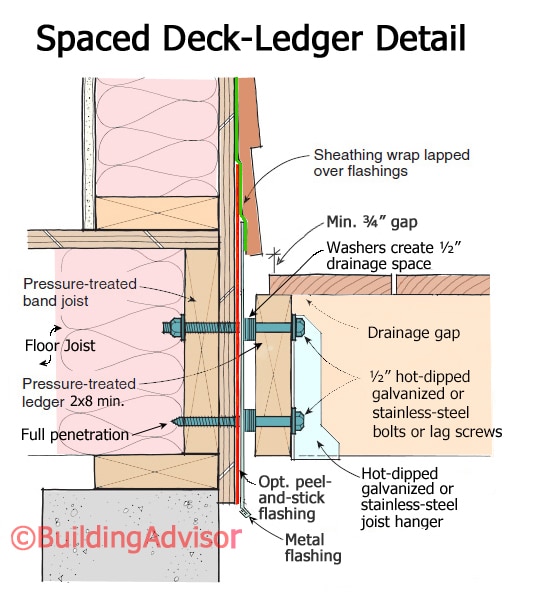

Is the bottom board that sits on top of a foundation of a building supposed to be treated?
Yes
On your deck a new thing they are doing is putting these plastic 1/2 inch spacers between the ledger board and the house to let air behind the board ,saves from rotting the house
They are like a little hockey puck with a hole in the middle for the lag bolt
