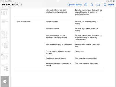

I've got a ms250 that I need to set the metering lever. Does anybody know what the lever is set at? Is it level with the bottom of the chamber or flush with the top of the carb? Thanks.

Normally flush with the carburetor body.
