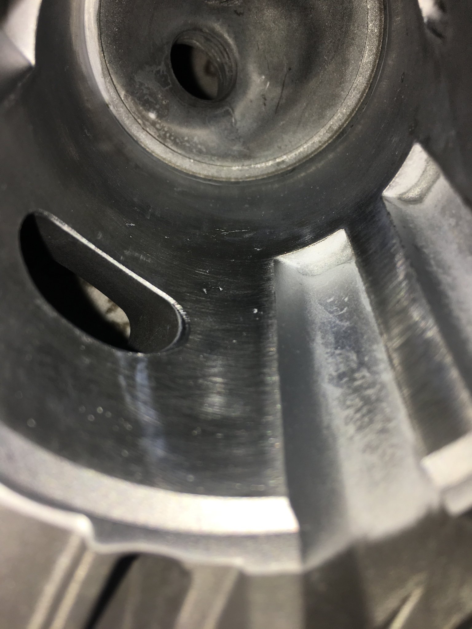

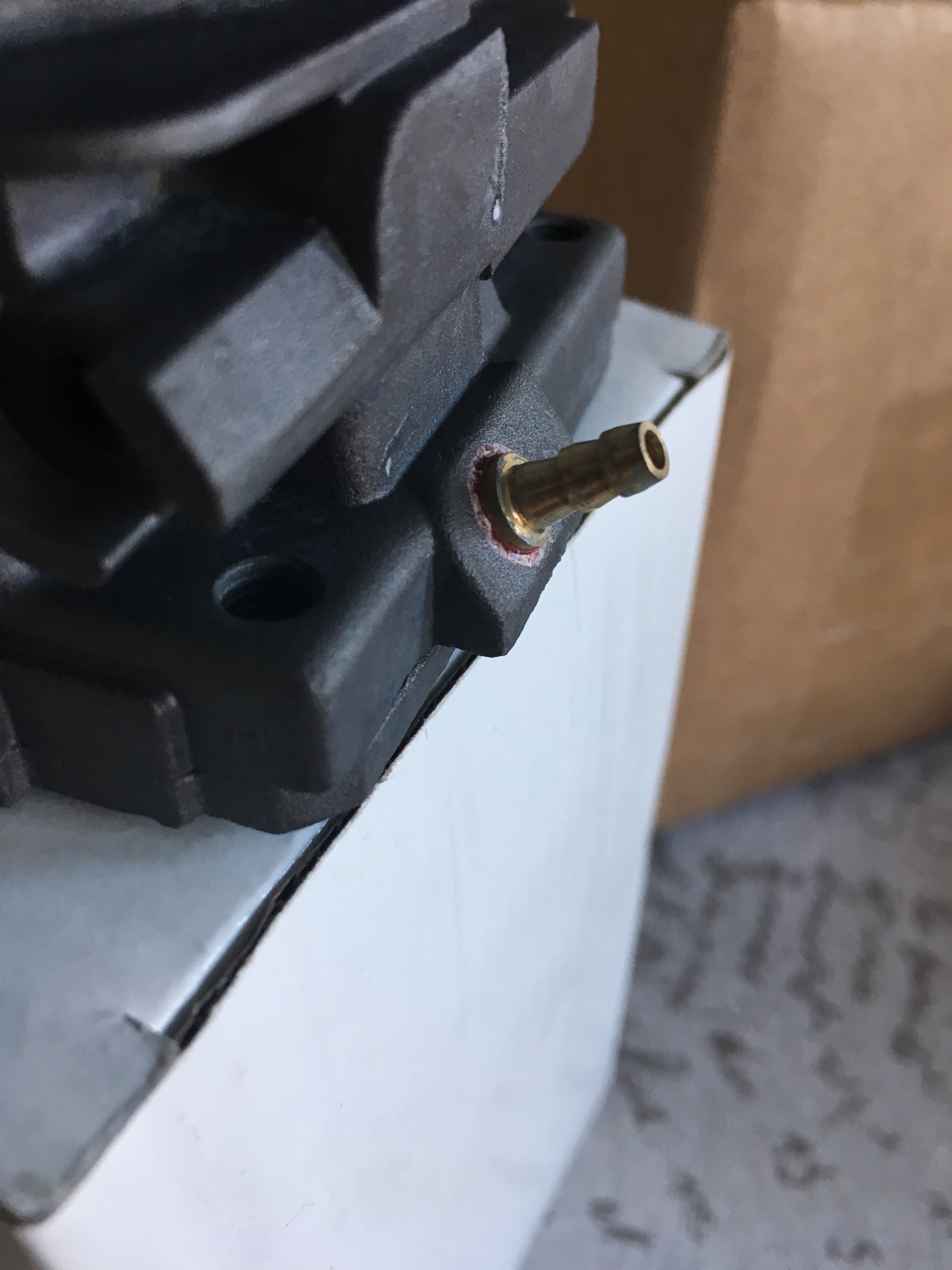

So this is the fourth cylinder kit I’ve ordered for the 390 from HL, over about a 4 years period. The quality seems to be dropping as the last two have looked nothing like the first two. I’m trying to build a pop up 390 but this crap is killing me. The last cylinder I had the saw mostly together to vac and pressure test it and the impulse nipple had a leak. So the newest cylinder comes out and I see this
I though great that is fixed! But then I looked at the plating...sad face followed
There are 6 holes that I can get my pick to catch on just in that photo and 3 more on the other side. I think I’m officially done with white box kits. The first two were so good though.
