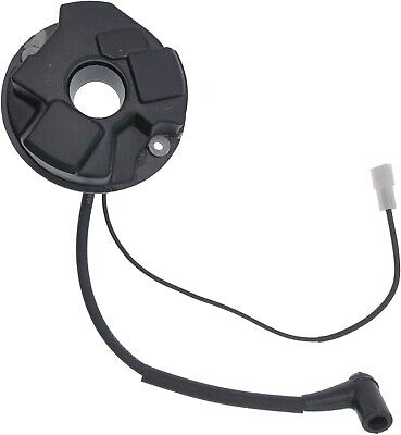

Hello i have a couple of husqvarna 2100cd saws, one has no spark, it has a totally different looking flywheel and ignition system, it looks like the one on the RH side with smaller fins and red HT lead and module,
Can I fit a replacement module from amazon or ebay? They look different

Unless you can make some kind of artwork out of it, there's not much you can do with the femsa parts, unfortunately.
A new SEM cd ignition is available from Husqvarna, as previously stated, it needs to be used with a SEM flywheel to function properly.

Somebody on one of the forums found an AM source for the SEM coil but I forgot who or where .At one time if you could even find a new OEM they were fetching in the $200 range .The used coil I got from Bryce set be back $50 .The saw is a screamer but lately I can't even roll it over .Needs a little attention evidently or a kick starter .

I got it to spark, was the ignition switch even tho I tested it like 10 times, end snapped off and then it started sparking, I didn't have a switch but had a 180s kill button.
