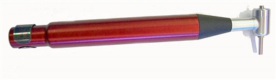

No kidding. It's scary how much I have spent in the past little while gathering supplies. You know anywhere else to buy attachments other then Amazon or eBay. I checked your sight out. I'm looking for a ra that the bit can go through.
The CC 182MC is the best RA that can pass a bit through.
