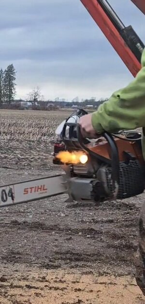

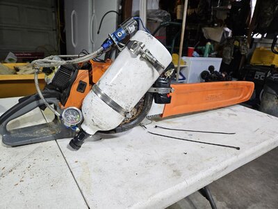

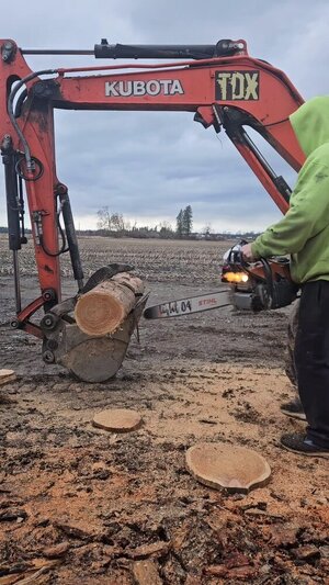

Thought I'd have a little fun with the China Girl. Turned her into a fire breathin Dragon! Lol

Think I'll step up the nozzle size. Plug looks good and very little deto signs.
I tuned carb to 13800 then out 1 turn...about 10500 now.
Tried 1.5 turns out but it won't run.
Tachs at almost 16k then 13ish in the cut.
Gives new meaning to the term "boom box." Clones aren't generally built super sturdy, inspect it frequently, don't want to see you hurt.
