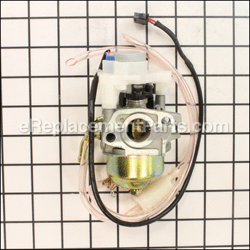

Threadjack! I have one of the small ones I got free. IX800, I think. Sat with gas in it and won't run with the choke off. It worked fine the last time the last owner used it but I found the problem when I started it. Is it the carb?

Yes most likely it is the carburetor gummed up with vanish. Be carefully with this one as has a regulator assy attached and I personally haven't see one of these yet but it appears one based on the Honda carbs. I believe this is a electric governor design. Looks like it would easy to though.
It looks like Generac is not going to provide individual parts for the carburetor either. The carburetor PN is 0H56810137., somewhere around 65 usd.
