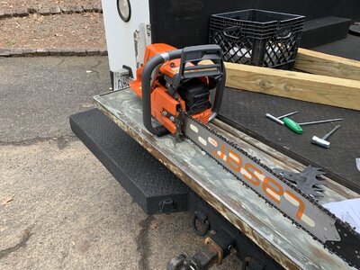

I’m gonna say yes, they are different. Here is the same wrap handle on a XT and OE. Picture isn’t the same but you can sorta see the gap. Pretty sure this is the XT part number.
