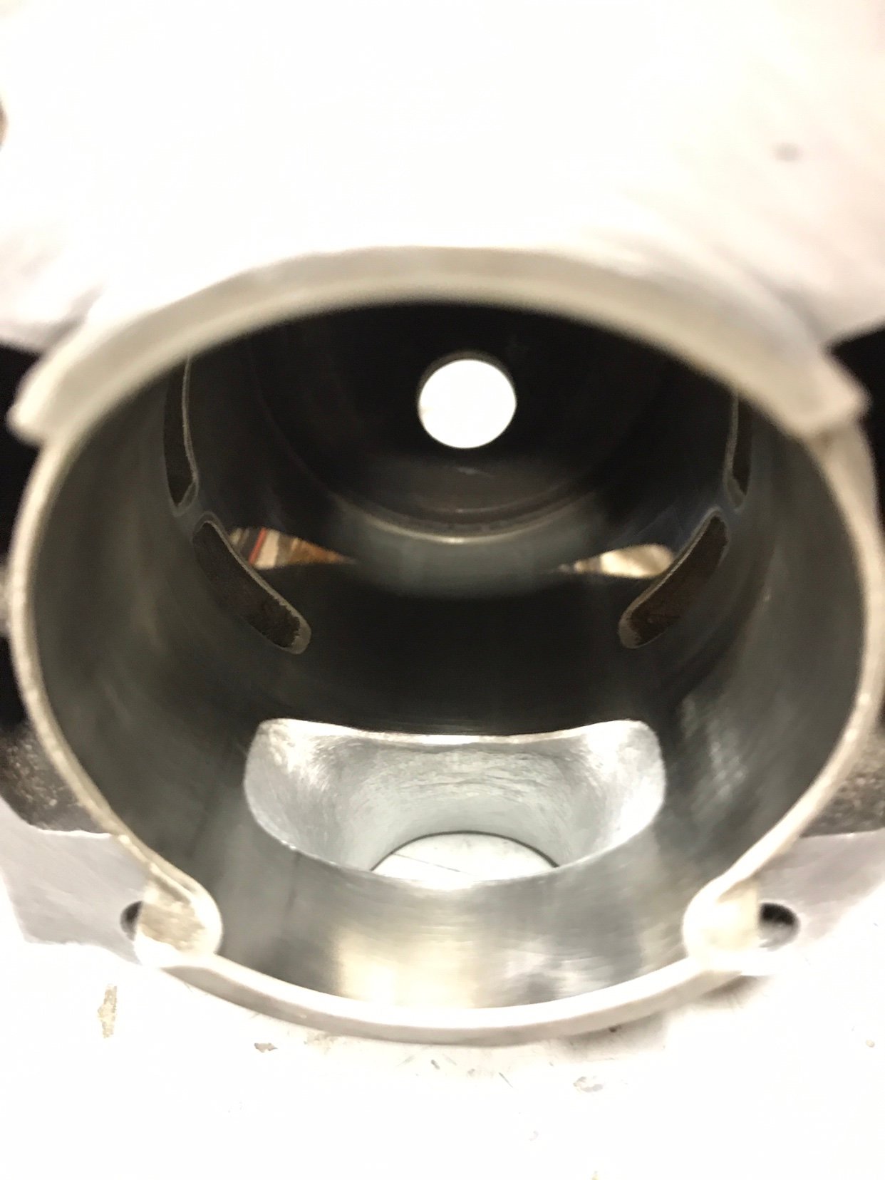

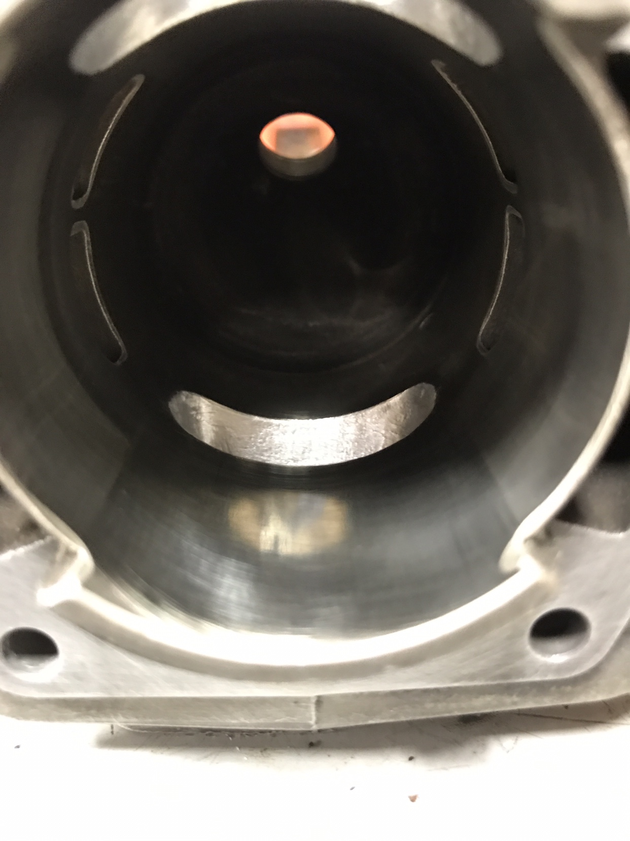

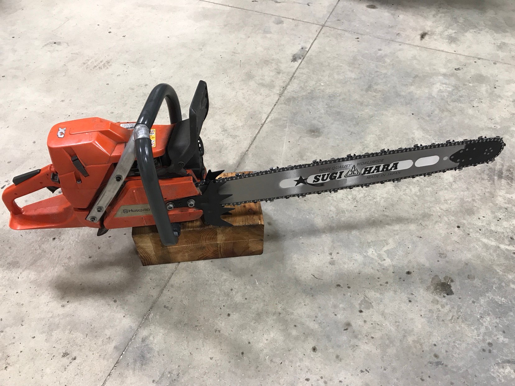

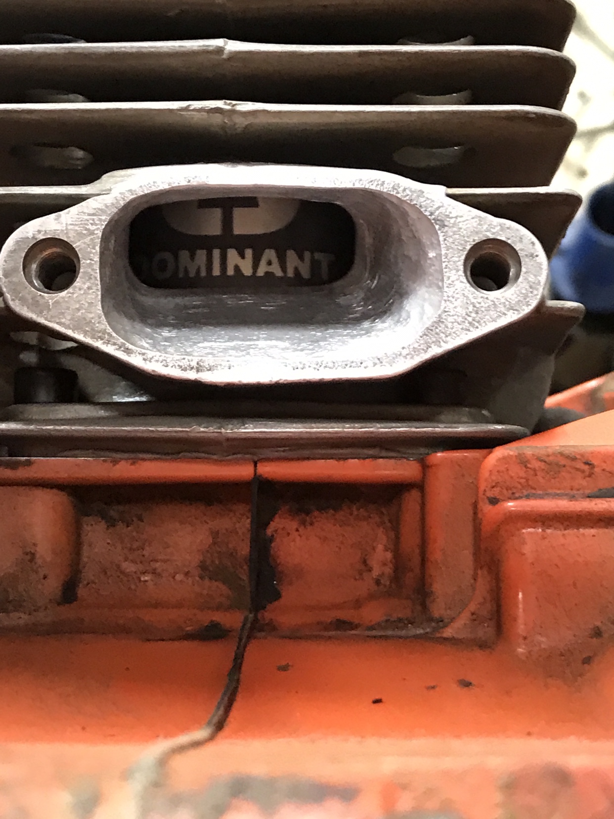

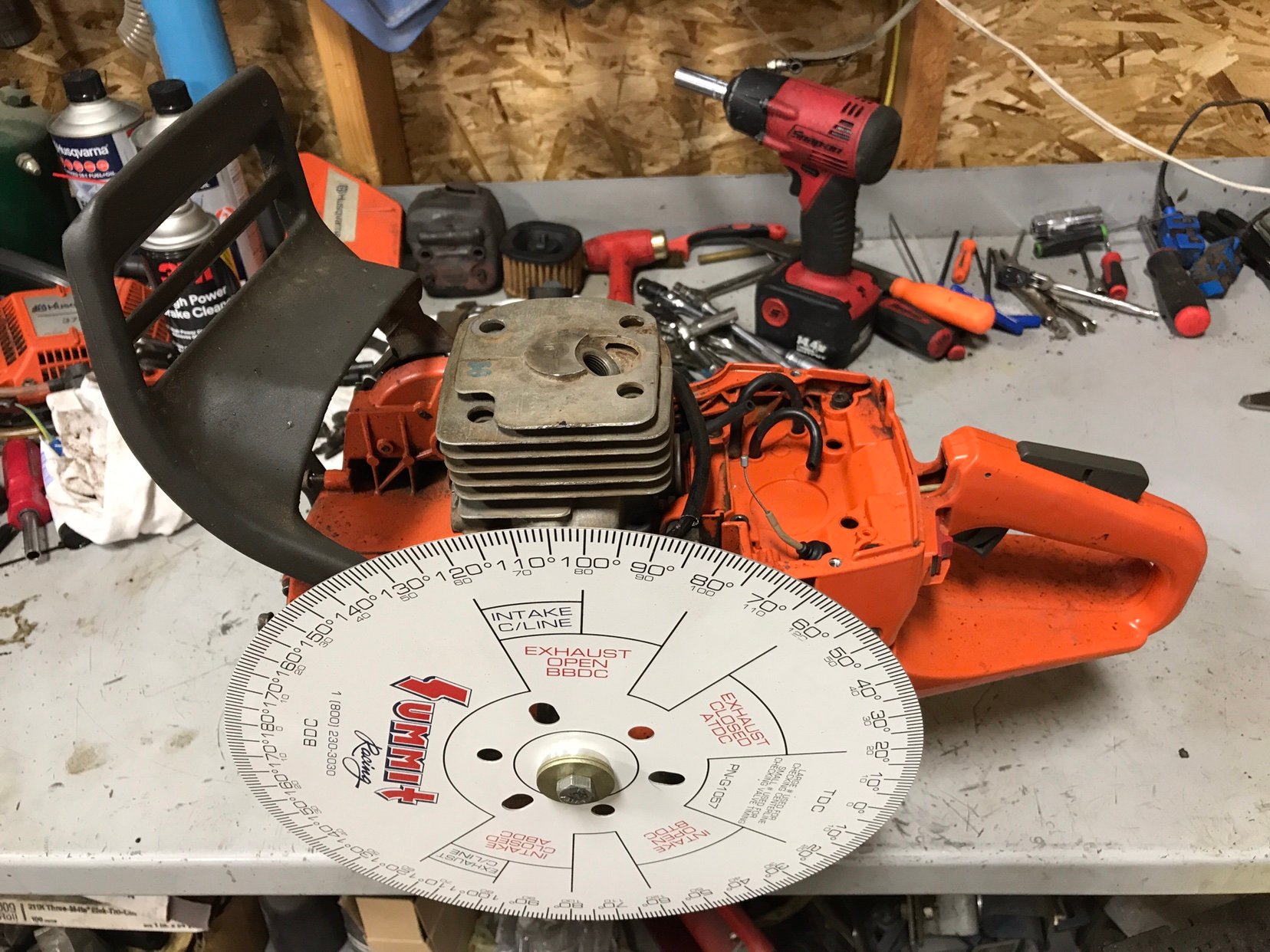

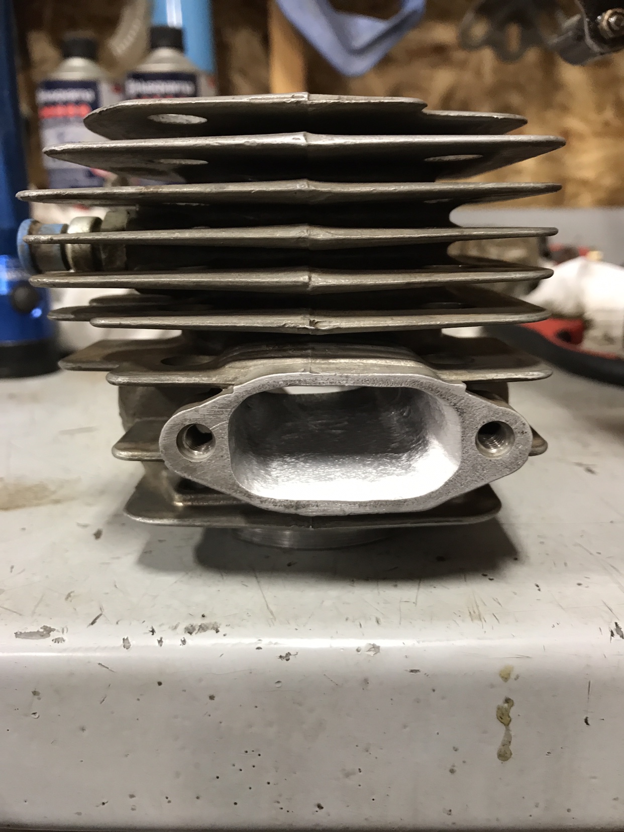

I finished up my 372xp port job and I love this saw again. I ported my 385xp and when I ran my 372, it just didn't have that wow anymore. So she got ported and i like how it turned out. Final timing numbers are 100, 80, 122. Squish at .23. Installed a Dominant Saw pop up Wiseco piston. Modded the muffler. Unlimited coil. Put a new Sugi Hara 28" bar.

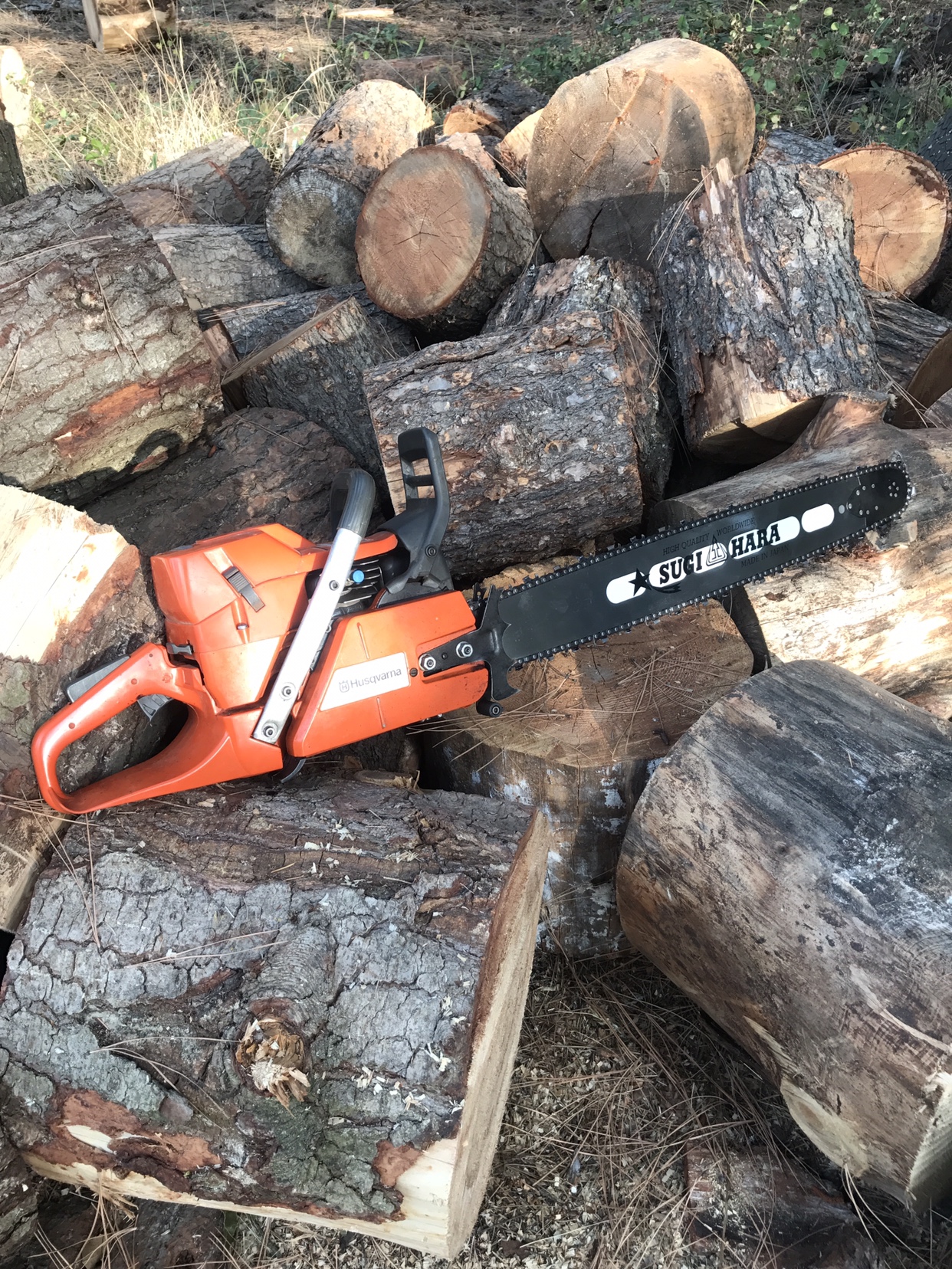

The 385xp def has more torque and grunt. But the 372 made the cut in approx 36 seconds. The 385 was approx 31 seconds. Not the same chain but similar. Both full comp 28" inch bars. The 372 I just reground. The 385 chain was new ish. Has about a cord of bucking up firewood on it.

Everything looks great except for the exhaust floor. It looks to be flat. I'd hate to see all that nice work go to waste with a snagged ring.

It does look like that in the picture. I may have took the pic before I chamfered the port opening. But I has a pretty good chamfer on it. [emoji106]
