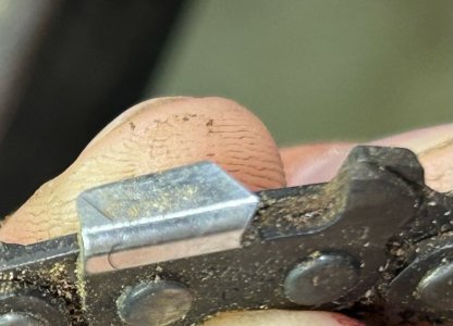

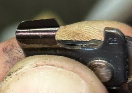

I have some semi stihl that cuts well, never had much luck with oregon. I figured out that the stihl "point" (not that there is much of one on semi chis) lines up with the line at the very top edge where it transitions from top plate to side plate. As we know from full chisel, that point or working corner is where we get our self feed from...so to make semi feed well, get as much of a point on it as you can. I think the 10 degree tilt that @Moparmyway recommended helps.
davidwyby
Rural desert logging
2:37 PM
5156
Jan 24, 2018
9,529
37,702
Extreme Southeast CA
The black chain is Oregon after I worked it over. The silver is the good stihl. The last one is Mitch zenobi’s
