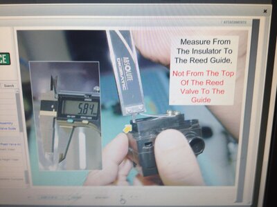

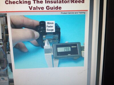

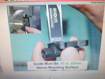

That blower has a double reed system in it. They are a *b-word to adjust
