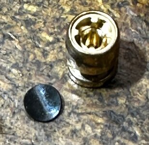

Filter failed, got full of dry oak debris. Sprayed it out with carb cleaner, still didn’t run right, pulled the Welch, sprayed more and noticed the rubber disc protruding into the bore. Punched it out…fixable ? Or replace?
The rubber disc can be reinstalled or replaced. However I would second Kevin and replace the nozzle. They are available just need to get the correct OD.
