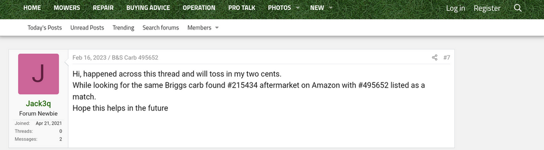

Found this, but I have no idea if the substitute part will work in your application:
#215434 seems to be widely available.
