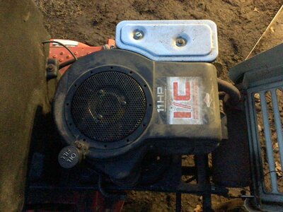

Hey all. Wondering if anyone knows if the bolt pattern is the same between the Briggs and Stratton 11hp single motors like in my JD S92 and Simplicity 5211 and the Tecumseh Enduro 13hp motors? There’s one for sale near me I want to put in one of my engine swap candidates if possible.IMG_7036.pngIMG_6931.jpeg

I cannot recall 100% if they are the same, but many of the mower engine frames had 2 sets of holes. I never recalled having to drill new mount holes when I was messing with mowers.
I'd make sure the PTO shaft is the same size as some of the Briggs had a 7/8" crank end vs the typical 1".
Other than that, youll just need to figure out the difference in throttle/ choke linkage and the different exhaust as the Techumseh exhaust port is in a vastly different location.

Thanks for the information. Another forum said the answer is yes, but wiring is way different.
