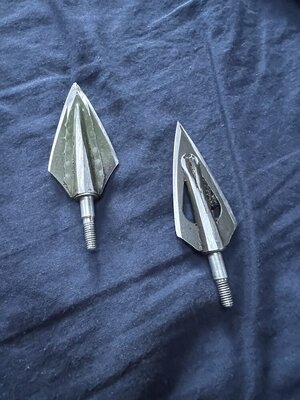

I know you said you have tried lots of heads but I still think that’s the most important thing for penetration. Here’s two that have gone all the way through multiple white tail shot from a 50lb recurve. The non-windowed are best. I believe these are Zwickeys. All the multi-blade and mechanical stuff is ridiculous. It’s meant to sell, and maybe do more damage internally. If you want damage, the single bevel opposed broadheads spiral in the cut and still penetrate well.
For some reason my photo won’t load. Stay tuned…

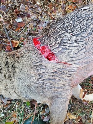

The doe I shot this year, my hit was a bit high and forward, she turned a bit just as I released.
I got 1 lung, she went probably 75 yards total.
The shot angle from 25 yards and 20' up I think is what saved me as it angled down into the lung.
The arrow got only about 12" of penetration though.
I can't for the life of me recall what arrows I was shooting from the previous bow, which was a Fred Bear, at 65lbs. Same heads, had almost all pass through though.

Those are big windows. The weight probably isn’t a huge issue on a powerful compound. Those heads would suck for a recurve. Still can’t upload a photo…

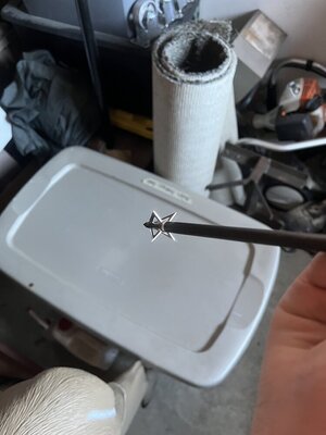

I’ve been shooting the VForce by Victory arrows for years now. I use Slick Trick 100g Magnum broadheads. I WILL NOT use mechanicals. My Mission Venture is set at 60 lbs and all have been pass through’s.IMG_8593.jpeg

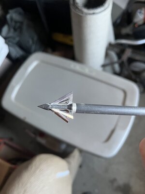

I have used mechanical broadheads for the last 20 years. Started with the g5 Tekan. Had a problem with one that had passed through and hit a rock. g5 told me to send them all back and they replaced 9 heads with Tekan 2's. Went to the g5 T3's for a few years and am now shooting the g5 Havocs. All have shot so close to field points.

The left one probably has 7 or 8 pass-throughs. It’s not crazy heavy, just low friction. I shoot Aluminum arrows though.
You can see some gunk in the windowed one. It often has hair and other stuff in the windows after a strike. Might be my imagination, but I feel like it doesn’t fly as well either.
