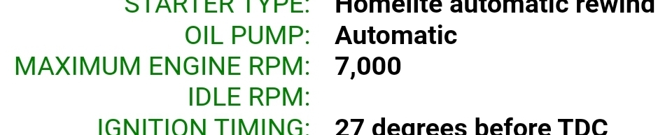

Theses saws don't rev but 6-7k.
The specs say this one doesn't rev high either.
