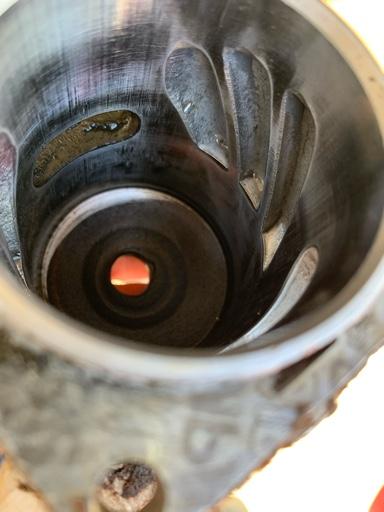

I got this from a fellow up in Mound City.

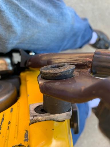

Almost no compression, AF mashed and upper right AV bushing gone.
How it got to NW Mo is a mystery. Have never seen another Alpina.

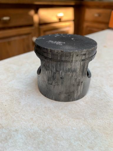

Wrist pin is a press fit in the rod and uses a pair of external snap rings to boot. Like belt with suspenders.

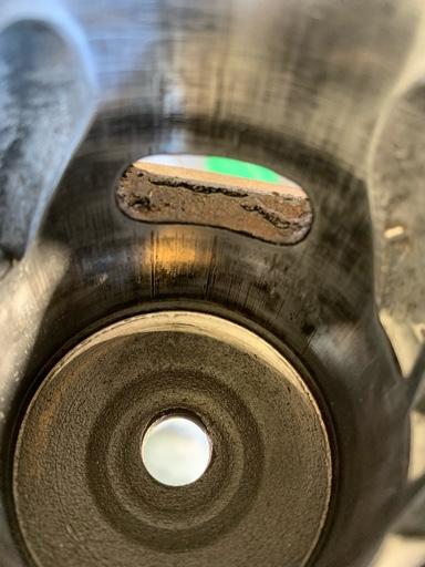

Cylinder cleaned up borderline serviceable.
That’s melted piston material in the exhaust port. [emoji90]
Three spiral transfers per side. [emoji848]
Piston kit was listed for $45 on evilbay but the handling and postage from Italy ($54) ruled that out. Potlikkers!
Finally nailed one listed by Warped5. [emoji108]
Cleaned up with new piston kit and fuel system overhaul I had a 140 psi runner.

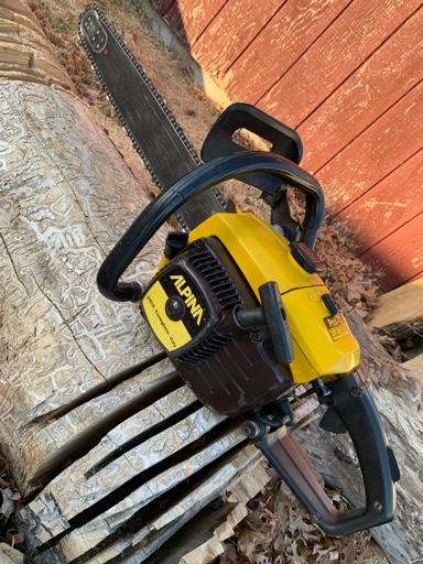

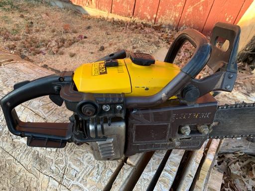

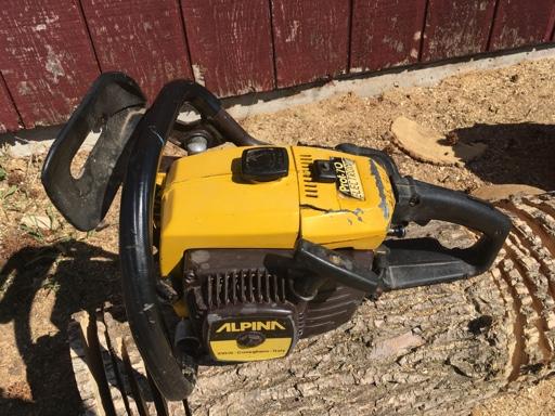

The bar oil pump system is a real Rube Goldberg but it works.
Found a NOS AF cover after another three months watching evilbay.
Remington 20” roller nose bar.
Clutch cover has a spring loaded bar dog.
Used a Stihl AV bushing subbed on the RH handle mount.
Works well.
We got some run time at the Iowa GTG. [emoji108]

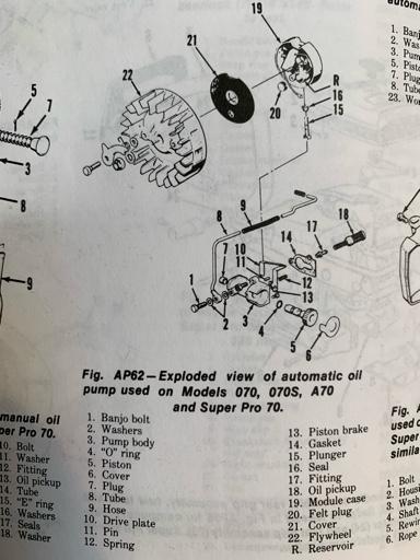

The Alpina oil pump.
A plunger (15) follows a cam ground on the crankshaft and it presses on a flat spring (10) that engages teeth on the pump piston (5). It ratchets the piston along. [emoji849]
What would usually be a points box (R) is level full of chassis lube to oil the push rod and spring.
